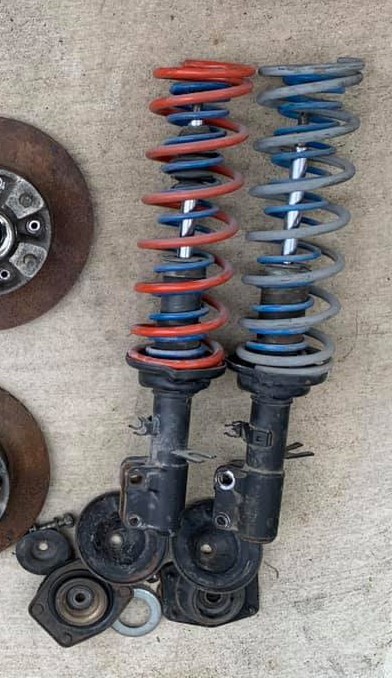

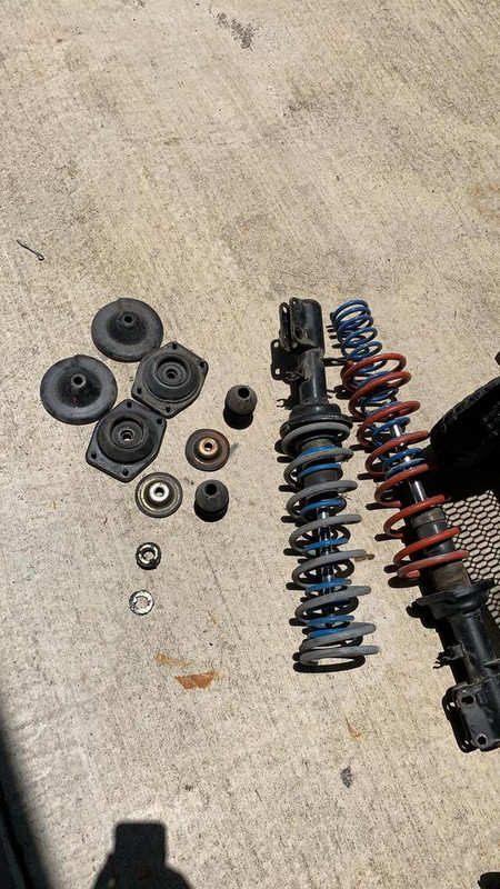

So last night I hit a pothole and blew out one of the "fancy" Monroe struts the previous owner of my car had installed. They sucked for the entire 12k miles they lasted, so no huge loss... I was planning on buying new Bilstein inserts, but came across these for a price I couldn't pass up:
What exactly am I looking at here? Are these name brand springs or something somebody cobbled together? Has anyone run double springs like this? If so, what was the result? Just a stiffer suspension?
I'm going to try them out and replace them with my stock springs if they're terrible. I won't know what inserts are in there until they arrive, so I took an gamble with the hopes that the spring setup isn't a total loss.

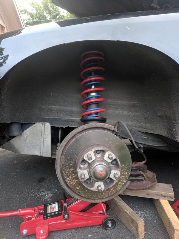

I'm absolutely amazed at how easy strut installation is on these cars. The old strut came out and the new one went in in about 10 min with no spring compressor. I ended up welding spring locating cups for the inner springs to the lower housing and the upper spring cap. They juuuust have a little tension on them with the strut is completely extended.
Here's a pic in case anyone wants to see:
I'll post up what (if any) difference this makes once I freshen up the rest of the suspension. Since I'm doing an alignment anyway, I'm installing poly bushings, tie rod ends, and ball joints at the same time. I'm also waiting on another strut bumper so I can install the other side. Hopefully that shows up soon so I can drive again.

Unfortunately I had to weld the inner spring perch otherwise I could have done this without needing an alignment. The key was unbolting the front sway bar on both sides so the A arms could drop enough to remove the springs. At that point, the strut insert could have been removed without removing the lower housing, but I didn't feel comfortable with the inner springs just floating around in there like they were.
I ended up using a jack under the A arm to get the strut back through the upper mounts. It worked perfectly.
