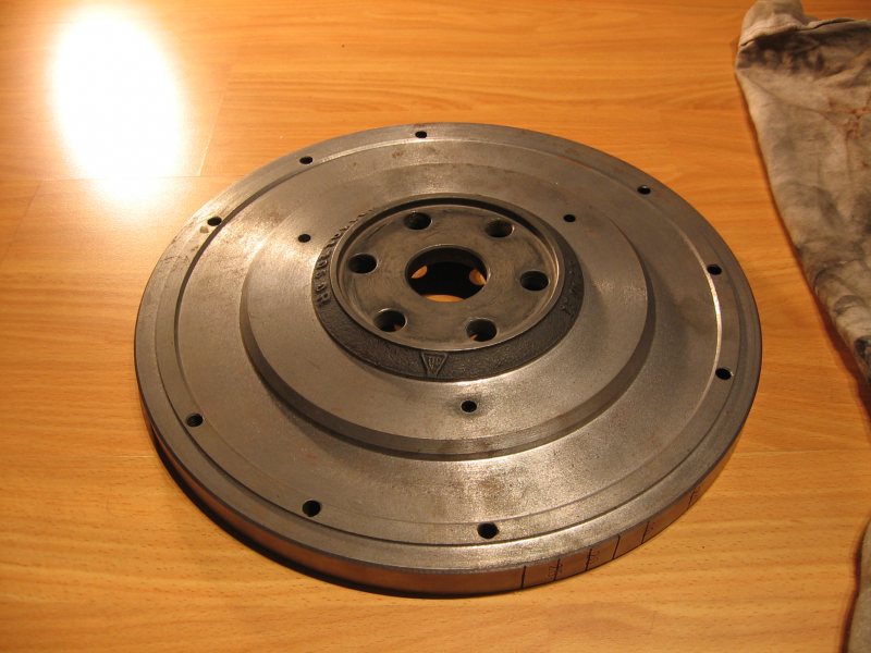

On an engine related note, customer was interested in doing a lightweight flywheel and pp setup. I know the pp is an easy one to find as its a 915 part and somebody is making those for sure. The lightweight flywheel on other hand I'm not too sure is being made as an aftermarket part. Apparently the s2 flywheel is a good bit lighter? Will have to weigh some tomorrow to confirm this. I'm sure it's in this forum somewhere too lol.
Ive ran that shifter for years, it works well, but I had some interference issues with the body insulation if i remember correctly. I spaced down the front bushing for the shifter to move the shift rod down slightly which solved that issue.
Regarding the flywheel, they are all very different , aswell as the different specific pressure plates they fit to(there are some combinations that were on these), so the easiest way would be to just shave off some weight of the current flywheel, the S1 wheel have some meat that could easily be removed, i even have on of those made years ago that I never used

After talking with the customer, we just opted for a stock s1 flywheel. Going to take a page out of your book and stick with what the engines design benefits and just feed it more boost and keep rpm down. Ultimately the head is completely stock minus an adjustable cam pulley so the top end couldn't handle extreme abuse either. We may run a set of stiffer springs that mittlemotor has.
Just got the centerforce pressure plate and the flywheel and morghens crank pully dropped off to machine shop and they should have it all balanced and ready to go for us tomorrow.
