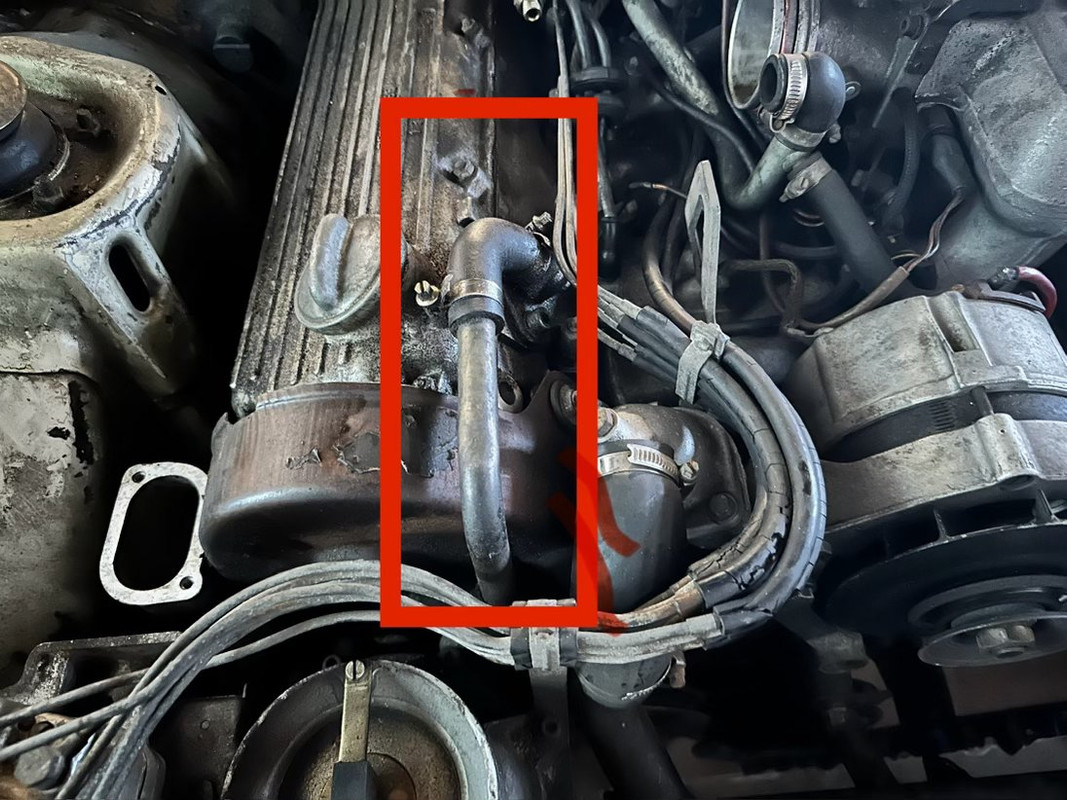

As I search for the expansion tank I decided to start with the basics and tackle the timing belt water pump. 3 hours later trying to get just the cover off I gave up. Went back to all the books and research and videos and.......
There is a hose overtop of the cover that is not supposed to be there.
...and the fun continues.
Cannot remove the cover it that is in the way. Stay tuned.

That pipe should be there, its aeration of the turbo oil drain, which was one of the upgrades porsche did on this engine over time. I don know how much stuff you have removed, but with a non modified cam cover you will probably have to remove most stuff in front of the engine.
When its off you will have to take your angle grinder and cut of some small tabs, the ones that are causing the trouble. After that it will be a breeze to remove, im not sure what sadistical designer who made that cam cover, but thankfully its easy to fix.
Ok. I have looked at a lot of other engines and never saw this. A late 82 revise I guess.
If it’s oil filled I can remove it then thanks.
Still sketchy on which ones are fuel or coolant filled. Trying to tip toe disaster!
Cheers.
I came std on the s2s, and some s1s had it adopted aswell later on. You can remove it, it shouldnt be anything inside apart from a thin film of oil.
