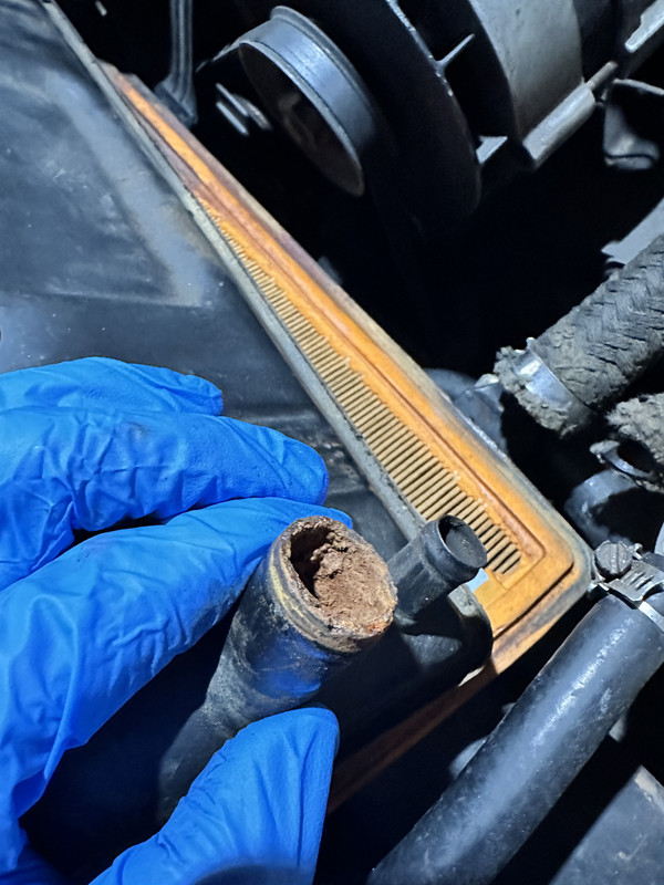

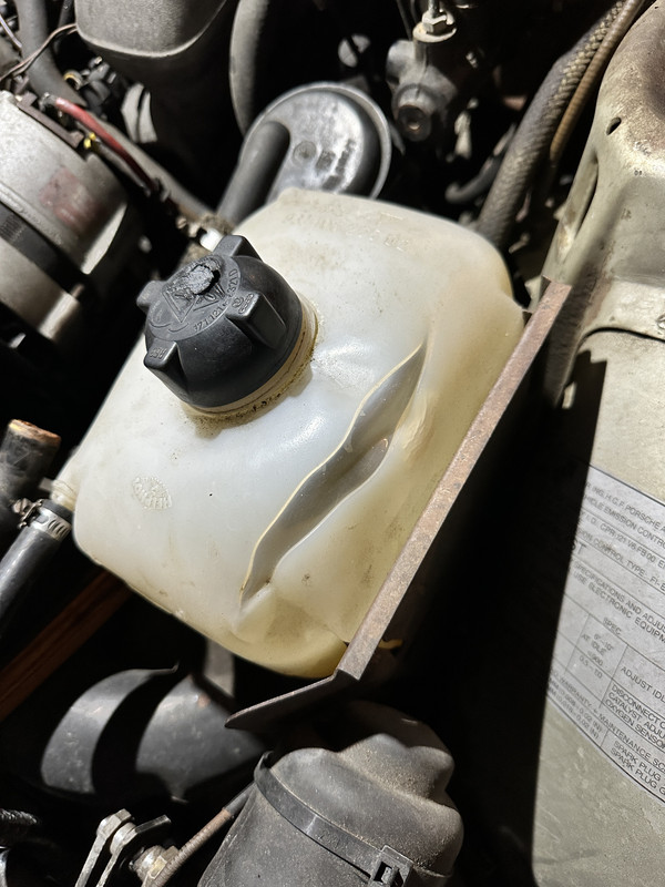

I POKED AROUND AND THE WATER COOLING EXPANSION TANK IS MELTED AND MISSHAPEN. AND THE LID IS CRACKED WITH A HOLE RIGHT THROUGH IT. OVERHEATING PROBLEM?

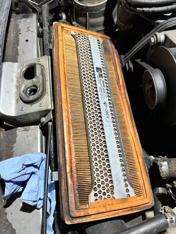

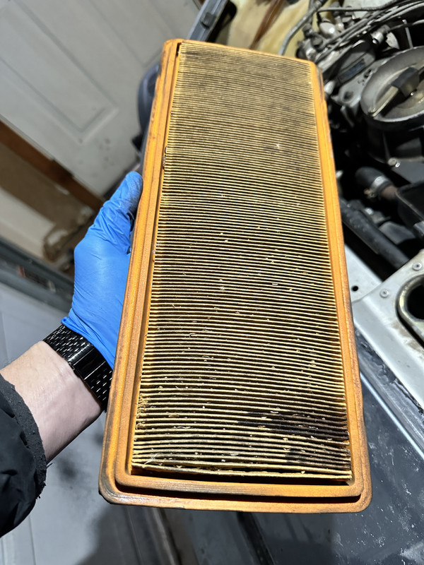

SO FOLLOWING THE TRAIL TO THE AIR CLEANER SYSTEM THEN BECAUSE THE LINES RIGHT NEXT TO THE EXPANSION TANK WERE ALL RUSTED. SO AIR FILTER WAS DIRTY [REPLACEMENT REQUIRED] BUT THE HOSE THAT GOES TO THE OIL SPERATOR AND THE OIL SEPERATOR ITSELF HAD NO LID BECAUSE IT HAD COME OFF AND LAYING NEXT TO IT. YIKES.

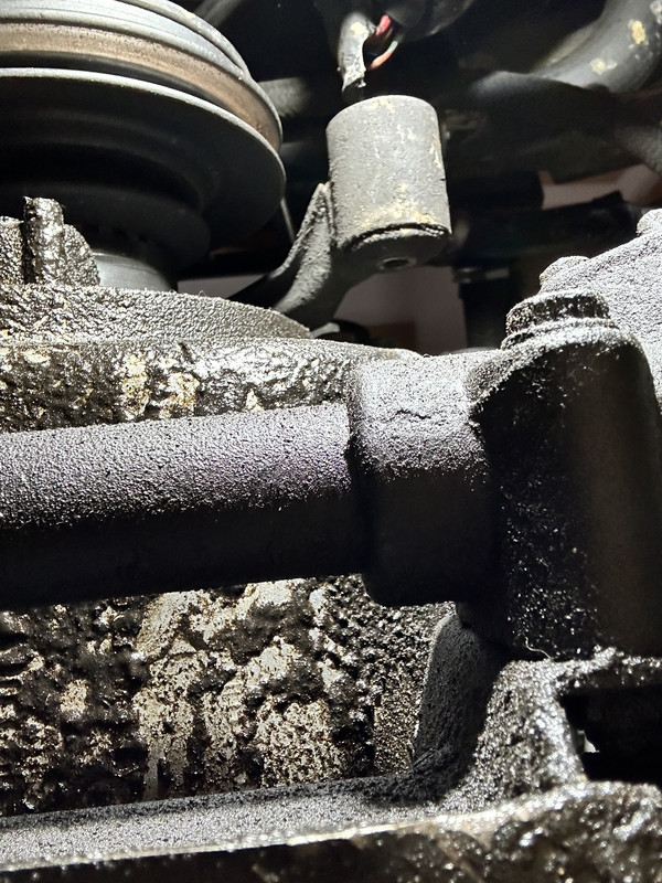

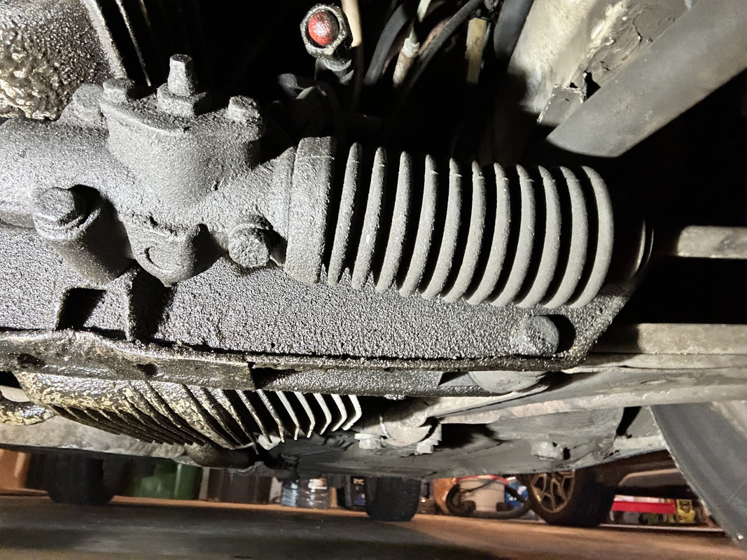

THAT MADE ME THINK [BIG MISTAKE] TO LOOK UNDER THE CAR THEN. IT HAS BEEN IN MY GARAGE 24 HRS AND SURE ENOUGH... OIL ON THE GARAGE FLOOR. SCHEISSE! I MEAN FOR A CAR THAT "RUNS AND DRIVES" BUT DOES NOT RUN IT LOOKS LIKE THE ENGINE TOOK A BATH IN CAKED OIL.

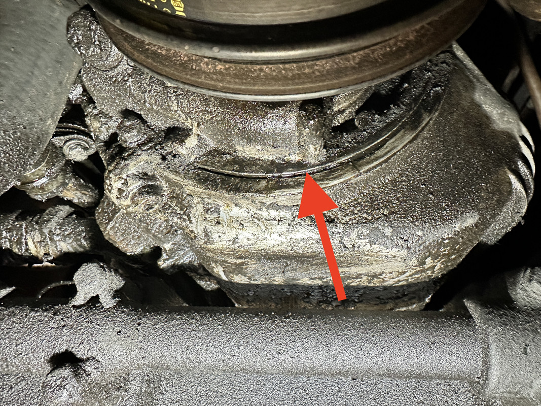

SO MOST OIL IS OLD AND CRUSTED. THE ENTIRE CROSSMEMBER LOOKS LIKE IS HAS A BLACK FUZZ ALL OVER IT. THE ONLY NEW OIL I COULD SEE WAS COMING OUT OF THE OIL PUMP AT THE BOTTOM [SEE PHOTO WITH RED ARROW] I THINK ITS THE OIL PUMP.

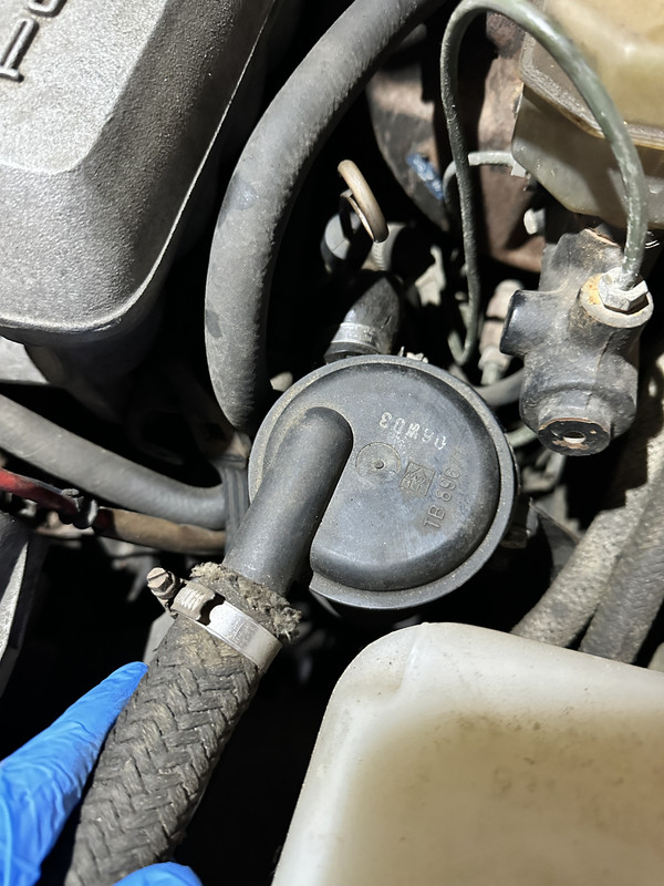

OH AND WHAT THE HELL IS THIS RED BALL STICKING OUT OF THIS HOSE?

I think a good cleanup of the engine would be a good start to isolate the oil leaks and asses the general condition, could be the oil seal on the front of the crank aswell, or multiple oil leaks.
The lid on the air/oil separator shouldnt be removable, i wonder if someone fettled with it previously.

First up...a good pressure wash of the engine/bay/underneath to determine where your probable multi oil leaks are coming from.
Then a step by step diagnosis of problems.

Brake Cleaner and a tooth brush is a method i use from time to time

Remove any sprayfoam, it does nothing good.
If the expansion tank is cracked it will "overheat" since the system requires to be sealed.
Also get the engine cleaned from all oil and crud... Fire hassard and makes diagnosis impossible, also its not very fun to work something that dirty.
Its horrible enough to work on a 931 without oil on everthing.

UPDATE 1/23/24
Was able to repair the Oil Reservoir. Replacing the hoses and hose clamps. removing the bracket and painting.
discovery leads to discovery!
None of the tank ventilation hoses were even attached to the Carbon canister in the wheel well. They were also cracked and will need to be replaced with canister before anything else.
Also the water cooling expansion tank is NLA from what I can see. Any thoughts or suggestions other than FB or this board?

PostPosted: Thu Jan 25, 2024 3:27 am    Post subject: Reply with quote
Expansion tank:
https://www.urotuning.com/products/coolant-expansion-tank-171121407f?variant=8392082391095
Not a perfect fit, but close enough, and much better construction than the converted milk jug from Porsche.

Posts: 978
PostPosted: Thu Jan 25, 2024 9:33 pm    Post subject: Reply with quote
Or use the 944 expansion tank.
Posts: 8982
PostPosted: Fri Jan 26, 2024 8:38 am    Post subject: Reply with quote
Yeah, I pulled my stock 931 exp tank and replaced with the 944 tank; frees up a good bit of space too!
