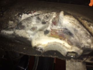

I was at the Glen this weekend and I took a little too much curb at the bus stop. Broke the studs right off the sway bar mount. I've had problems on this side before so I think there's a binding issue i need to fix.
My thought is to find the part pictured. I think I'll have to drill out the 17 or so spot welds, then weld the new one in. If anyone has a better suggestion I'm very willing to listen.

Mine came off completely. I used a long 3/8" drill, and drilled straight through the frame rail. And then used long bolts! Worked.
