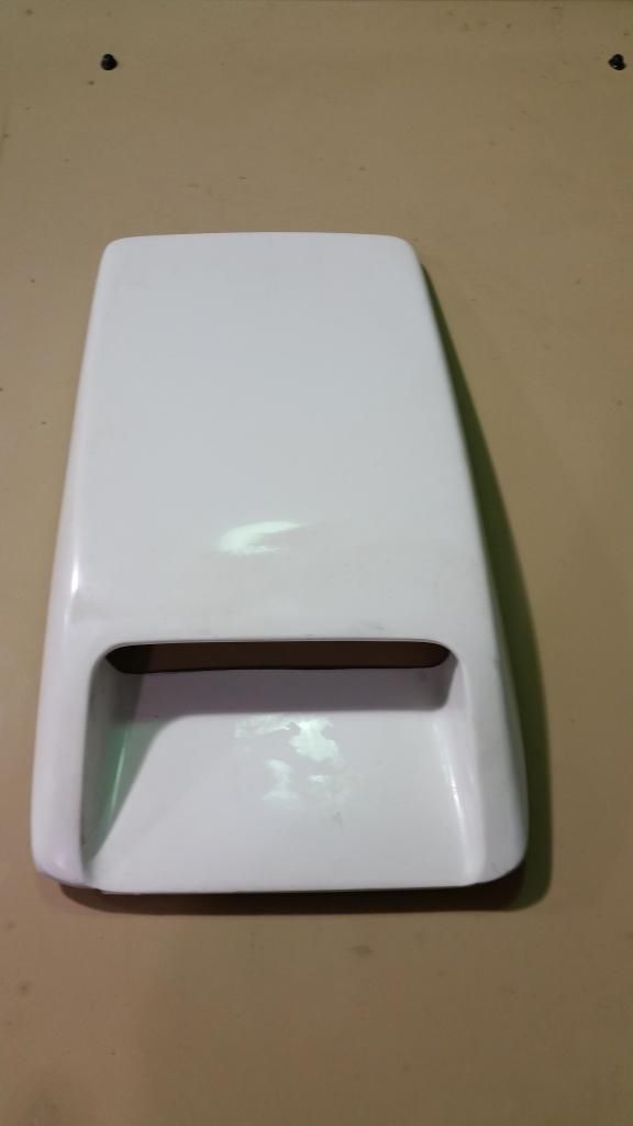

PostPosted: Tue Dec 16, 2014 1:17 pm    Post subject: Reply with quote
GTR style fiberglass hood scoop.I am not too thrilled with the quality but I guess I have to live with that,it should be OK with few finishing touches.
