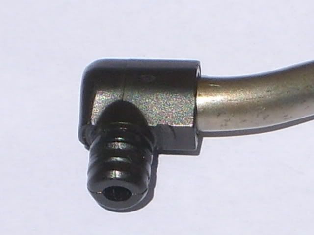

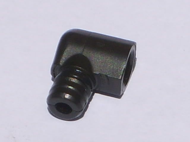

How many 924 owners would be keen to replace the POS plastic part with a direct replacement reliable aluminium or brass one if they were available at reasonable cost?

Considered ally or brass too and I`m not fussed either way either. Only ally is cheaper and easier to machine.
Figured "reasonable" is <$20 since this is a 924 part and is $16 at Pelican for the plastic one or probably a bit more at the dealer.

If you are interested in making some I am happy to buy one from you. We both know that realistically to make one from start to finish will involve many hours work, measuring, design, sourcing materials, tools, set up, turning, drilling, deburring, cleaning, testing, etc..... So personally dont wish to make more than one for myself. If there is much demand it may be worth having a machine shop do a manual run of 10 or 20. With economies of scale it may also be worthwhile having a CNC shop spit out say a minimum run of 50-100. Obviously then the price per unit will fall dramatically.
Hope you all can see where I`m coming from. This is why I am trying to gauge the interest and demand before I waste much time or money.

I think making a good part would take more than a few minutes of thought, and a little more work than one might think.
Brass would not be good because vibration would crack it.
O-ring seals on each end would be required to seal, since you can't duplicate the locking rings on the plastic part. Viton seals would be best, and that means grooving the oil delivery tube end internally, and grooves on the exposed end on the cylinder head side.
O-rings would also allow the elimination of metal to metal contact, and frictional wear of the parts in contact, to give the part a long life.
