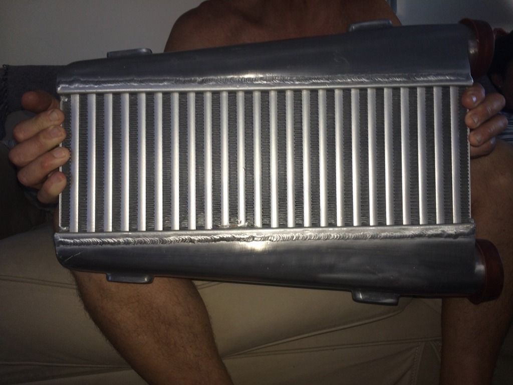

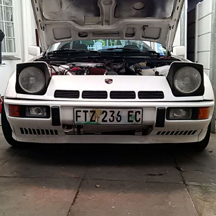

I've installed a U-flow intercooler, similar to the unit that Morghen has installed in his car. The unit literally only just just fits in-front of the radiator, with the whole width of the cavity space available being utilized.
here is a picture of the unit.
[img]

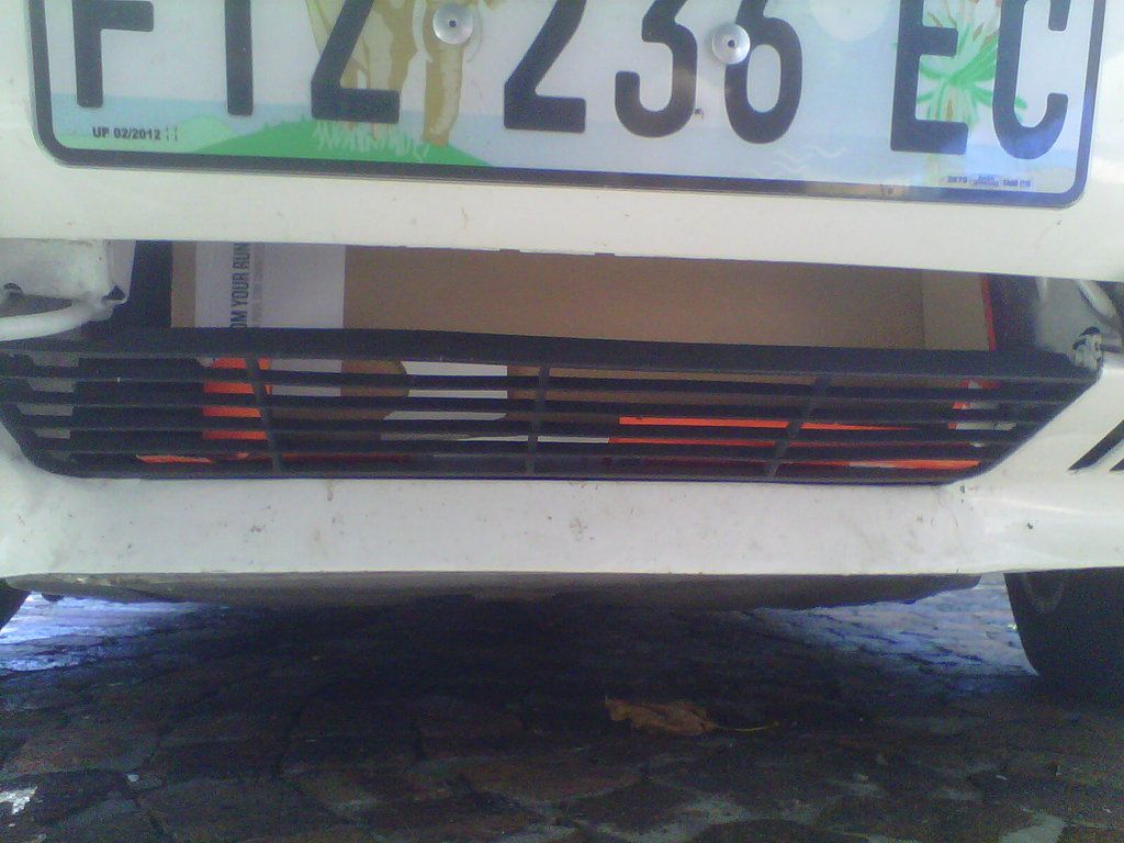

I used cardboard to check whether the unit would fit, such as in this image below:
[img]

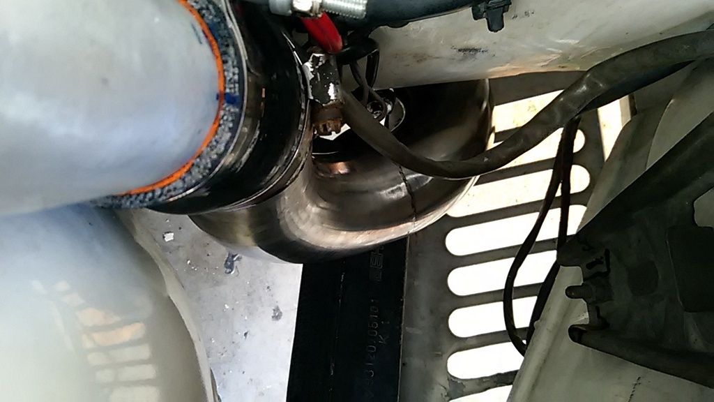

The piping I used was 2' aluminium from the turbo to just past the dizzy, it is then taken to 2 1/2' stainless steel piping to the intercooler. from the intercooler its a combination of aluminium and stainless steel. The aluminium piping running over the dizzy was squashed slightly to fit past the bonnet. The clearance past the bonnet is minimal. A lot of time and swearing was required to make the piping fit.
Here are a few images of the piping from different angels:
[img]
[img]
[img]
[img]
[img]

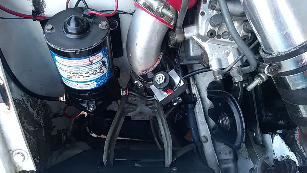

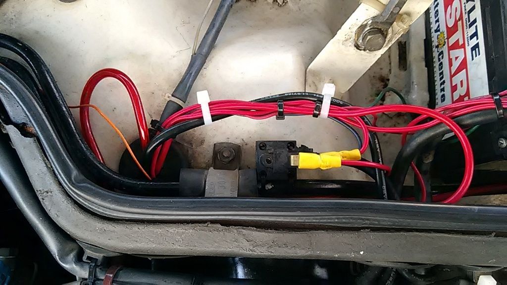

The PO installed a stage 1 cooling mist methanol injection system in the car. I had removed the unit a while back due to the relay breaking and turning the pump on with the engine off.
But with the intercooler in I decided to reinstall the system, this time putting the relay inside the car with additional on-off switches. Here are images of the pump, solenoid valve (a feature I added to stop the solution seeping into the engine under vacuum, as a one-way valve aren't sufficient when the car goes into vacuum IMHO).The stainless steel canister on the shelf is used to contain the solution.
[img]
[img]
[img]
I'm running standard 10PSI boost, I have the meth kit spraying just pure water atm, and I think the additional water to the system, even with ambient temp of 30+ degrees celcuis, is just to much and is drowning the spark. Any comments on this?

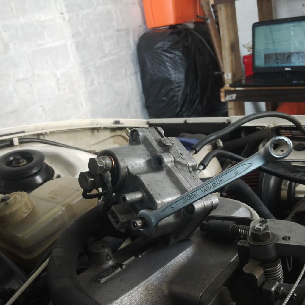

I installed a wide band O2 sensor and gauge. The gauge indicated that i was practically pouring fuel out the exhaust. However I couldn't correct the A/f for WOT conditions without destroying my idle A/F, the car would hardly run. So I installed a new WUR, the car performed better but the A/F was still rubbish and again I couldn't correct it to the point at which idle and off idle was nice and responsive whilst having correct boost A/F so I made up a CIS tester, and decided to make my old WUR 'three point' adjustable.
I tapped a screw into the bi-metallic strip pin allowing it to be moved up and down. I them drilled a hole through the brass stopper on the underside of the unit, to reveal the warm control pressure set screw. This doesn't need to be sealed after making the hole, it is a sealed compartment from teh rest of the unit. And then by tapping the brass stopper in a was able to decrease WOT boost enrichment. Because these measurements are all interlinked, I'd recommend tapping the enrichment stopper in first 1mm, and then hooking the CIS tester up and adjusting Cold pressure and then warm pressure. Here are images of how I did it:
[img]
[img]
[img]
When I set the pressures, due to my car always tending to the richer side, I set the cold,warm pressures to the higher pressure limit within the specified range. Due to higher pressure meaning leaner mix. This worked well. My idle is at 12.9-13.9. Normal no boost driving is at 14.5 to 15, and then WOT 3500rpm is at 12. 4500rpm is at 11.5 5500rpmt is at 10.5. These figures are with the methanol injection off. Methanol injection richens it up.

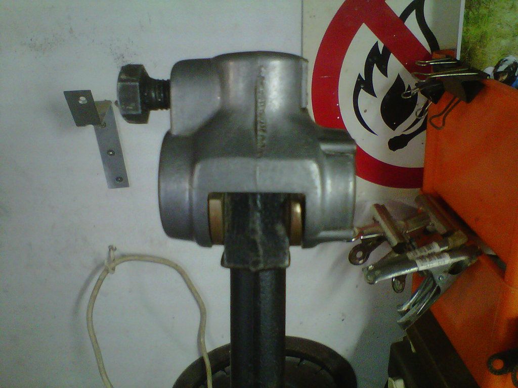

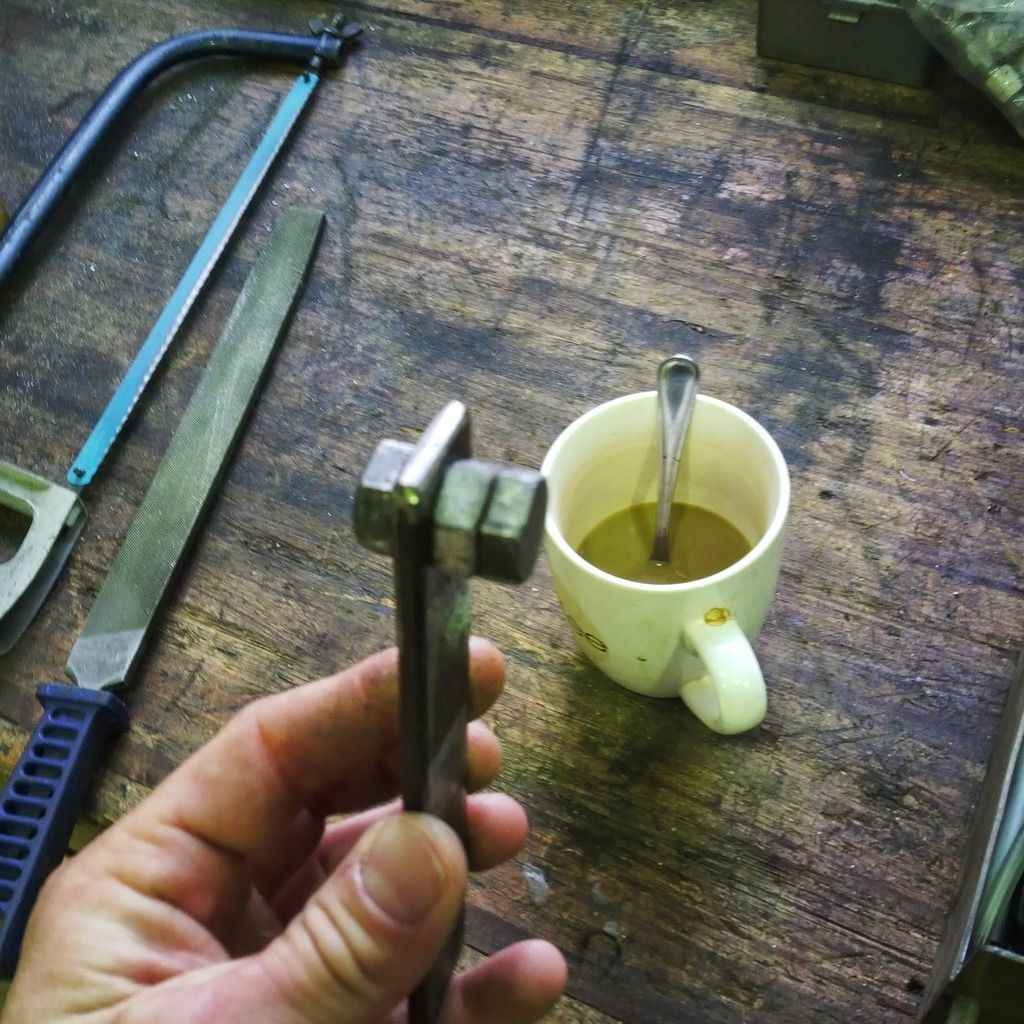

A few people talk about brass shift linkage bushes. Some are worried that this would cause unwanted vibrations. I got two brass bushes made up for a six pack of beer at my varsity workshop. There is no sloppy play in my shifter anymore, there are no abnormal vibrations being transferred down the shift linkage. They are easy to make and cheap and will never need replacing again! here are images of mine.
[img]
[img]
[img]
Changing the linkage must have been the hardest job I've done in this car! I listened to someones advice who said it can be replaced with the tranny in place, NEVER AGAIN! it was hell to get out and worse putting it back!

Lound clunk is ok, you should be able to hear it from the driver's position with open windows but not or barely with the windows closed. Thats how mine sounded before i replaced it with a larger K27 hybrid.
Your intercooler setup looks better than mine !
Congrats, it looks like a nice car !
