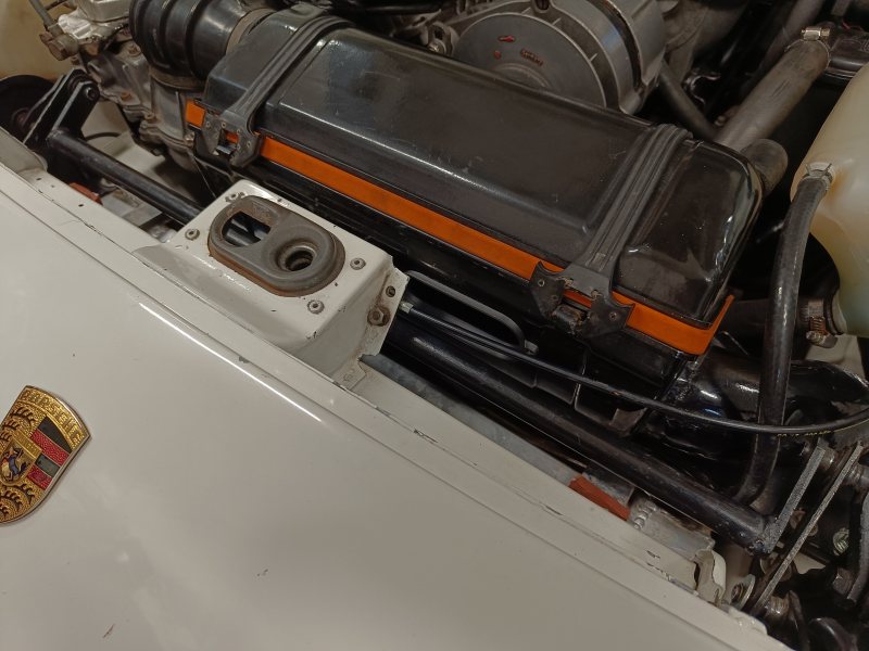

After a looong time i finally took time to do some intake temp work, i even bought a spare air box many years ago to have something i could cut into or modify.

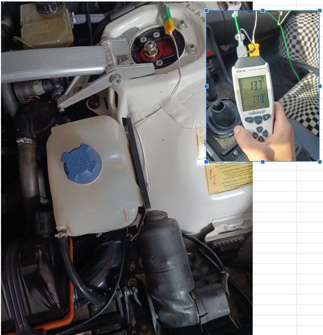

The original plan was to make a new larger snorkel out the fender to match my additional power, but first I had to check how the original intakes actually works. I know since my flow bench adventures that the snorkel is a bit small and creates some unnecessary restriction, but the intake temps were also a question. I didnt have the chance to try on track, but I tried to drive hard on country roads with full throttle, full brake, full throttle repeated many times until temps was stable to see how much it would rise, and then did some measurements around the airbox, and realised that there is not need for any complicated solutions, i just made some intakes to the front nostrils and it worked great, so good that im not sure i will seal of to the radiator as I planned.
The measurments were done with a thermocouple, with one sensor in the airbox or wherever i want to measure, and one reference sensor jammed in the door for a reference value to measure the difference.
Results(temp in the lower part of the airbox vs outside temp), difference in Celsius:
Orginal aribox:10-13 degrees
New holes and orignal snorkel open: 3.3-3.5
New holes only:2.2-2.5
So the OEM box isnt bad, but could easily be improved upon, i didnt have the time to measure the restriction differences, but I will do next season. Less intake temp means less compressor work needed, the same with restriction. More compressor work means more back pressure and less power, but mostly its fun to fiddle with stuff and make it work better.
Printed in PCCF, bellmouth in the inside and outside with a lip to cover the cut edge, m3 nut hidden on the inside parts. Made templates to facilitate cutting. Each hole is roughly the same area as the original snorkle.

A good way to start is just putting a sensor there and see how bad it is / if it is bad, it also depends how you use the car. If you just cruise around with the occasional blast its a different thing to running full blast, which puts a lot of heat in the radiator and thus in the engine bay.
The IC help, but not completely, since the increased compressor work will be there regardless of cooling efficiency. Its not massive at these levels, but if you pull a lot of heat it can be. _________________ 1980 924 Turbo

Did you have the n/a variant that goes over to the right side of the car over the rad i guess? Never understood that design, oddly enough the early ones go behind the pop up light out in the left wing, a much better sport, one could wonder why, maybe it was to fix intake noise legislation or something like that.
As an engineer having worked with engine development i rarely just do stuff, without at least some analysis, measurement, testing, calculations or similar  _________________ 1980 924 Turbo
