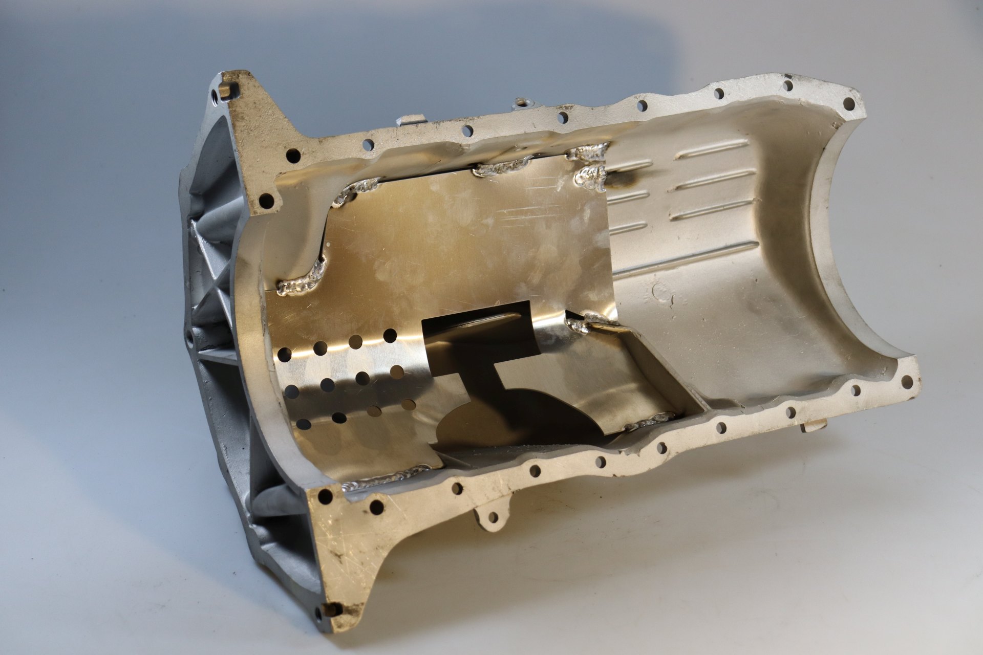

I thought I saw some pics of a baffled sump/oil pan somewhere on here years ago,can't seem to find them again. Anyone got any?

I put one in recently from mittlemotor, a very simple sheet metal thing. But apparently it works in their race cars. Was it that one or some more complicated trap door thing?

Mittlemotor made a couple of versions of it and had pics. I made one as I had some problems with the only fellow who makes crank scrapers. It is currently sitting on the shelf.

I can send you a picture of what I did if you send your email. It was pretty near a copy of the Mittlemotor one. I had a crank scraper on my race engine and I believe it would have accomplished the same thing as the baffle. I saw one time where Mittlemotor had a combination scraper and baffle but didn't save the picture at unbelievable price. I made mine by just making cardboard patterns until I got it about right, it was a pretty strange pattern to get it to fit over the oil pump when putting it on the block and then of course the dipstick got in the way also. Probably about 10 cardboard patterns to make it work. I then made one from some alu diamond plate I had around and had it welded in.

PostPosted: Tue Jul 16, 2024 11:03 pm    Post subject: Reply with quote
This is from their website, i think i put some in my car thread after installation.

Nice one Cedric

Ill just add that the IJ crank scraper couldn't be fitted at the same.time as the pan baffle, at least not without modifications
