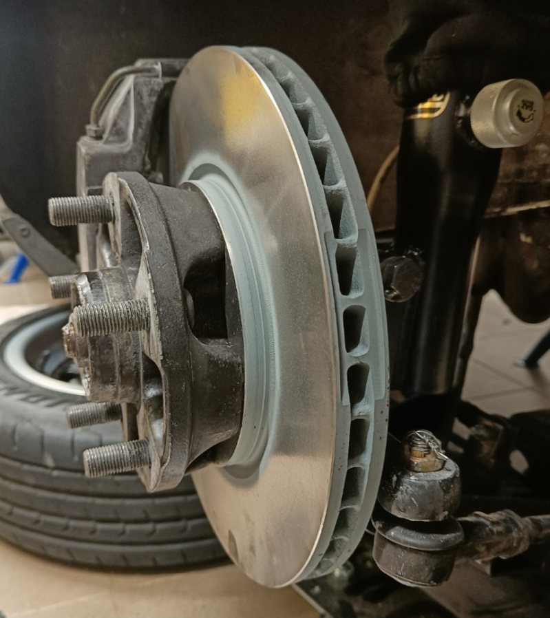

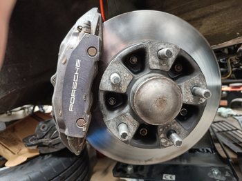

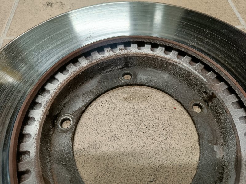

Work has been progressing, and protoypes has been tested, adjusted and tested again, its very small changes to get everything perfectly centered up. And I also got my 24mm discs, so i could sort out the final measurments.
Pretty happy with the location of the caliper now, so I think im gonna work a bit on the design to prepare for ordering of the steel ones.

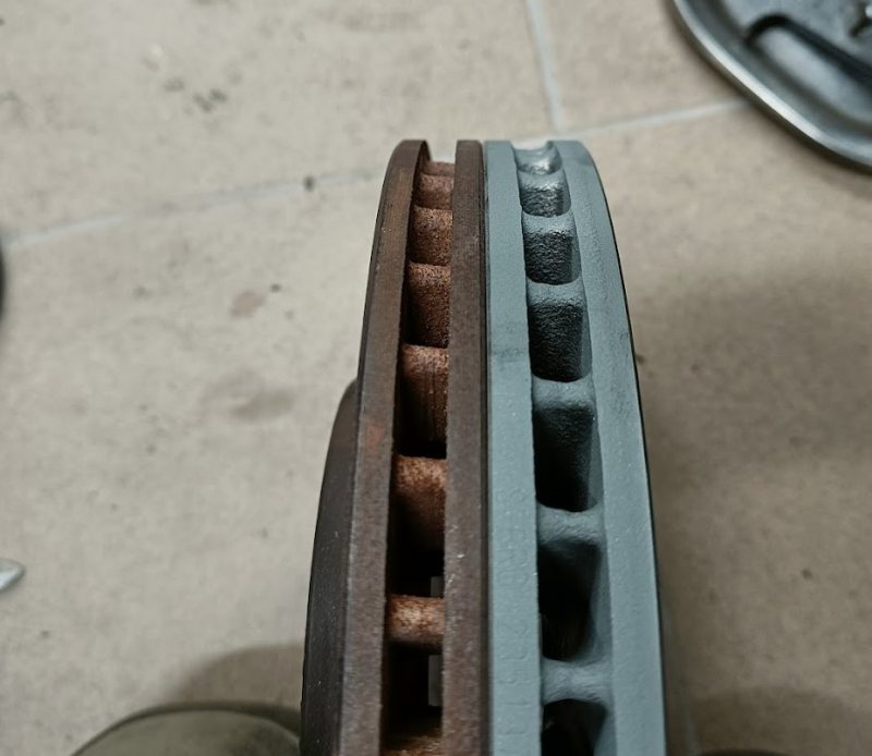

The thicker discs has significantly more flow are in the cooling ducts, this looks vert promising for the heat management.
20,5 vs 24mm disc
difference in cooling channels
with the thicker disc installed
