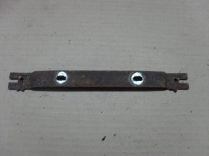

PostPosted: Wed Oct 10, 2018 10:53 pm    Post subject: Reply with quote
All UK cars would have had a metal bracket bolted to the bumper. The plate was then attached to the metal plate. The plates are still available from Porsche if you don't have one/two. Many have been removed by previous owners and self tap screws or double sided tape employed.
The new version which needs a bend at each end to mimic the original

PostPosted: Wed Oct 10, 2018 11:09 pm    Post subject: Interesting Reply with quote
I don't have either of them! PO must have ditched them. Rear plate is bolted into the holes that would hold the brackets. Front plate is stuck on. Thanks for info!
