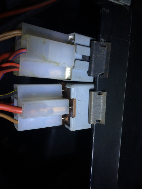

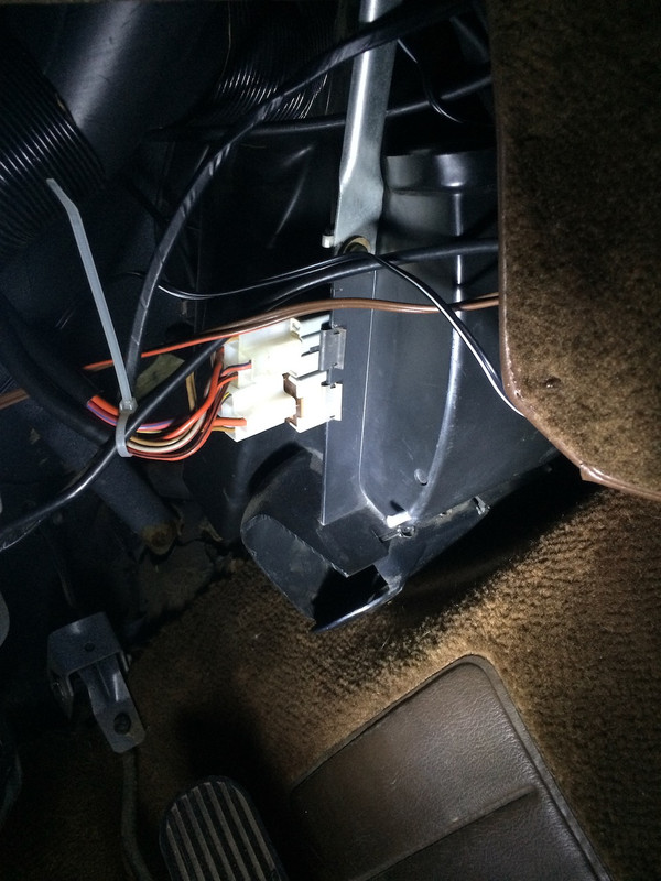

Hi. New user, and new to 924s, so there's tons I don't know, but I do have a Weissach. I've just been spending a lot of time in the driver's footwell. That relay clips to the fresh air blower. I can't figure out which relay it is. Should be pretty easy to ID with the fat red/blue wire, but I'm not finding it. I think it must be the air conditioner relay or the cooling fan relay. I can send a couple of pics of what mine looks like if you let me into the secret of posting them.

I am pretty sure this relay is for radio

Oh no, why take the dash cap off??!!?? It's better not to know!
I expect you're past this point, but let's just see if I can post these pics:

PostPosted: Fri May 01, 2020 11:57 am    Post subject: Reply with quote
Hmm, OK. Should be 2 different ones. And they are very small.
Try this:

PostPosted: Fri May 01, 2020 11:58 am    Post subject: Reply with quote
Progress!
Now the other:
