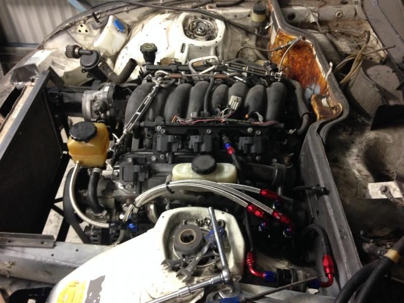

So far the projects going well, been a while on it but only cause I'm in no rush...
This is the 245kw SS motor, spec stage 1 clutch, shortened torque tube carrier, 3" stainless exhaust, modified stainless headers, ford hydroboost conversion, EPAS steering conversion, modified x member/engine mounts
rebuilt relay/fuse box and body loom.
Waiting for a few parts still to arrive, need to reinstall wiring and mount a few parts, finish rear exhaust etc...
