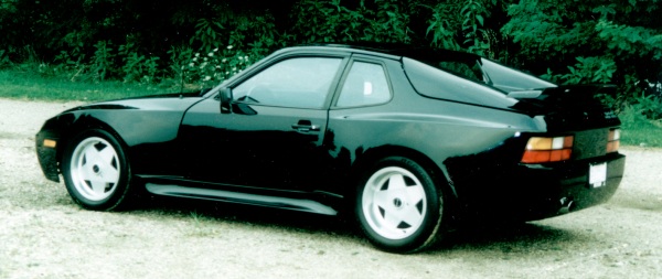

Here is my only question: side skirts or no. Right now the side looks black where the side skirts are. I would at the least match to the same color.

You go applebit that will be awesome um you do need side skirts of some kind. Ilike the skirts on the black car.
need for appearance or need for a technical reason because of this conversion?
