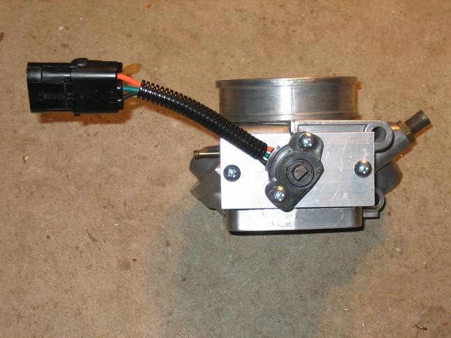

PostPosted: Mon Jun 08, 2009 7:41 am    Post subject: Reply with quote
This is how I installed my Haltech TPS on my Weber T... not pretty, but it's on the underside.
G.
