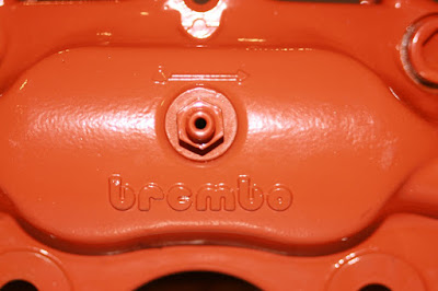

Sneak preview of my Brembo brake calipers, which are in the process of being rebuilt:
They're not quite done yet, the vendor had some issues sourcing the scraper rings and some other bits. Also, the PORSCHE script will be scrubbed of the paint and polished.
