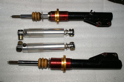

Thanks Dave! Re: the camber plates, you're right, as the Ground Control strut housings do not accommodate the camber adjustment at the spindle, you have to have adjustable camber plates up top:
88 924S SE | 82 931 Holbert | 81 Euro 931 | 81 Weissach | 80 US 928 | 80 US 931 '941' | 78 D-Prod Replica | 78 w/D-Prod kit | 78 Poli-Form | 78 Limited Edition
