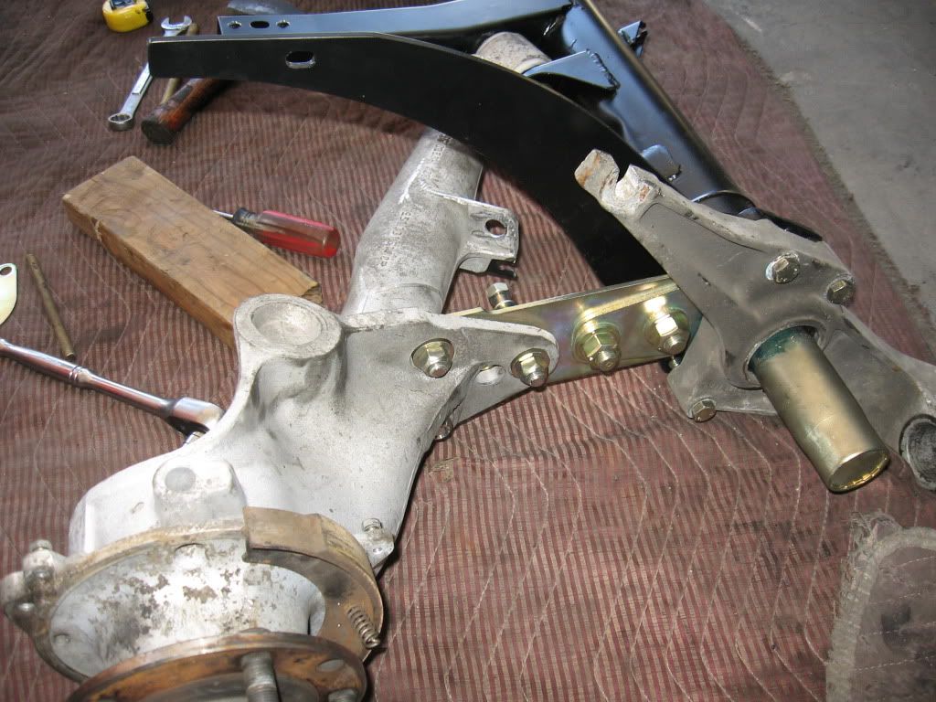

PostPosted: Wed Sep 02, 2015 3:07 pm    Post subject: Reply with quote
Oh yeah, did it. The unsightly result:
  • Weiße (1987 924S) - Turbo S3

PostPosted: Thu Sep 03, 2015 6:23 am    Post subject: Reply with quote
Paint or wire wheel?
Posts: 11383
PostPosted: Thu Sep 03, 2015 7:20 am    Post subject: Reply with quote
Carrier was powder coated, spring plates and hardware were electroplated with yellow cad.
