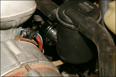

Pix of my recently refreshed engine bay on the 941. In addition to touching up the valve cover, script lettering, and replacing ALL of the vac lines and elbows with silicone, I have eliminated the stock airbox because I'm sick of the stupid improvised wire clips that the PO used to replace the missing rubber straps. I was also keen to replace the stock air filter with a washable reusable element, and thought that the cold air fixtures from Toucan Industries would look nice.
To do so, I had my welding buddy fab up a piece of aluminum tubing, 3" OD x 13" long. He reduced the passenger side end to 2.75" to accommodate the stock air boot, and welded the two nipples required for the breather / vac lines. I will eventually paint or powder-coat this piece.
In the process, I also re-installed the air-oil separator, which the PO had also removed. I had one from the 931 Ultra Wide Body project that it won't need, so I reinstalled it. Since my preluber installation takes up the second plug on the oil pan, I also installed an external breather element to the bottom of the air oil separator. Here are the photos:

You lost me here though (the lower connection is an oil drain - aren't you going to end up with oil leaking out the added breather?) -
ideola wrote: | Since my preluber installation takes up the second plug on the oil pan, I also installed an external breather element to the bottom of the air oil separator.

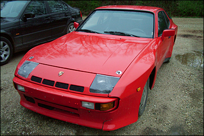

Actually, no, it's not a typo. I did indeed mean to say 941. This car is not exactly a 931, and not exactly a 944. It started life as a 1980 (Series I) 931 with the snailshell gearbox. Somewhere along the way one or more of the previous owners changed the powerplant to a mostly Series II setup (but not completely, as it doesn't have the SII DITC).
But it also has a lot of 944 bits, including bonafide steel 944 quarter panels (NOT fiberglass knock-offs), front facia, and custom rocker panels. Apparently, the original 931 had the four lug, cuz this one was converted over using 944 bits (i.e. alum trailing arms et al) to a five lug setup. I know it had four lug originally because I just completed swapping out the handbrake cables, which had the original setup that came with the drum brake (i.e. four lug) configuration. I also replace the shredded, cracked vinyl 931 seats with some early 944 seats.
But it still has cues of the 931: the vented nose panel, naca duct hood, and smaller 931 tail spoiler. Since 941 was never designated (to the best of my knowledge) by Porsche to any of their models, I dubbed this car the "941" to avoid confusing it with the other 1980 931 I own (which is currently in pieces but being assembled into my Ultra Wide Body race car).
Here's a pic of the 941:

Posted: Tue Feb 12, 2008 10:38 am Post subject: Re: Up Fixin Der Engine Bay on my 941 |
Smoothie wrote: | the lower connection is an oil drain - aren't you going to end up with oil leaking out the added breather? |
Good question, Smoothie. I won't know until there's no salt on the roads here, though. When I got the car, the crannkcase breather was attached directly to the airbox with no air/oil separator, which didn't seem like a good idea to me, but also did not appear to produce a lot of oil into the air box. Of course, with the separate reinstalled, it may actually cause more of a draining problem, so we'll have to see what happens. If it becomes too big of a problem, I'll figure out some way to drain it, even if I end up having to rig up a catch can. We'll see what it does. _________________ erstwhile owner of just about every 924 variant ever made |
