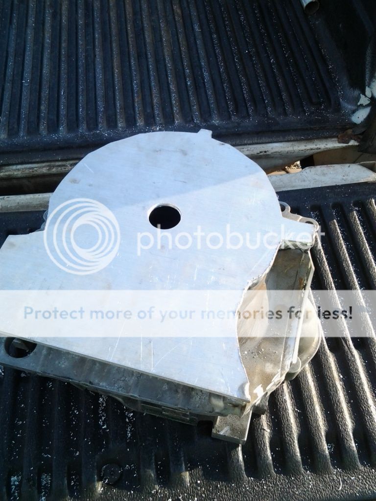

There's a hole in it.
PostPosted: Wed Oct 29, 2014 11:02 am    Post subject: Reply with quote

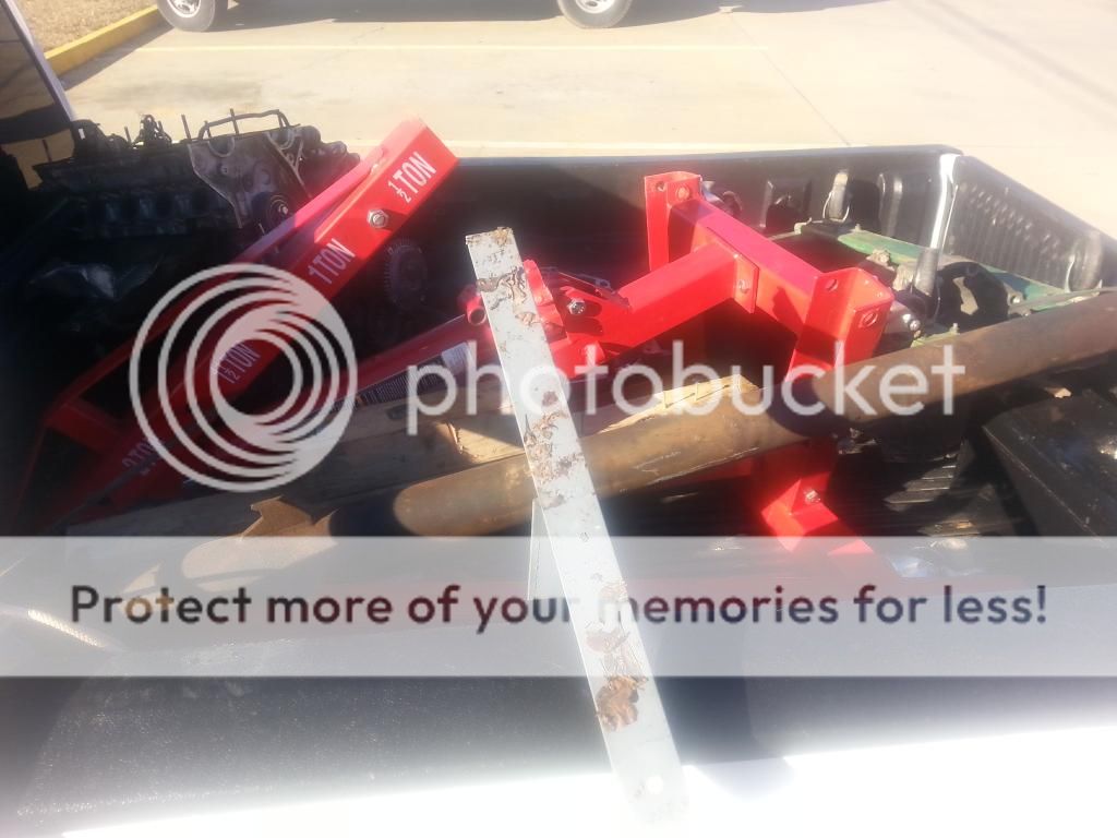

PostPosted: Fri Jan 09, 2015 9:06 am    Post subject: Reply with quote
I received gifts in the mail.

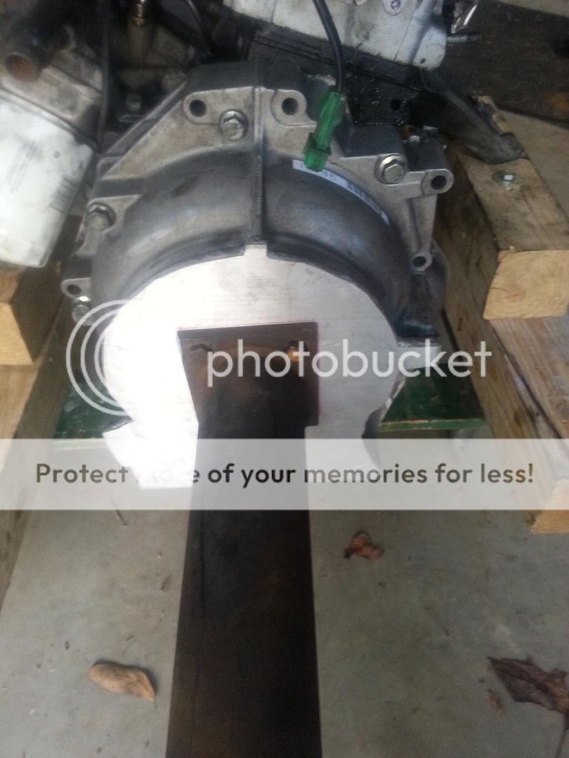

PostPosted: Sun Jan 11, 2015 10:19 am    Post subject: Reply with quote
Had a busy day today.

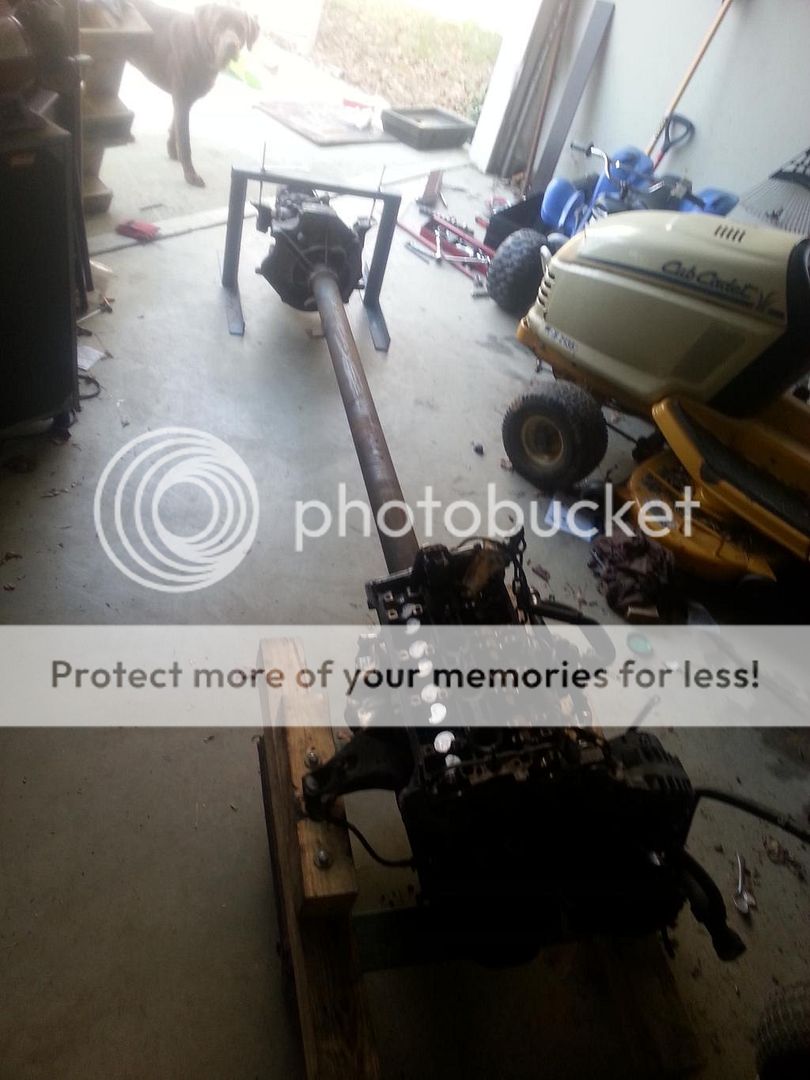

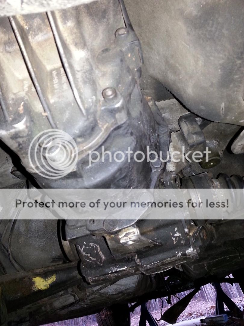

I've run into an issue. The Ford slave cylinder I was going to use is too tall so I have to figure out another way to actuate the clutch. On the bright side I got the 944 torque tube and transaxle installed. Well mostly. The coupling still has to be made up and I lost the pointy bolt that connects the shift rod to the tranny linkage.

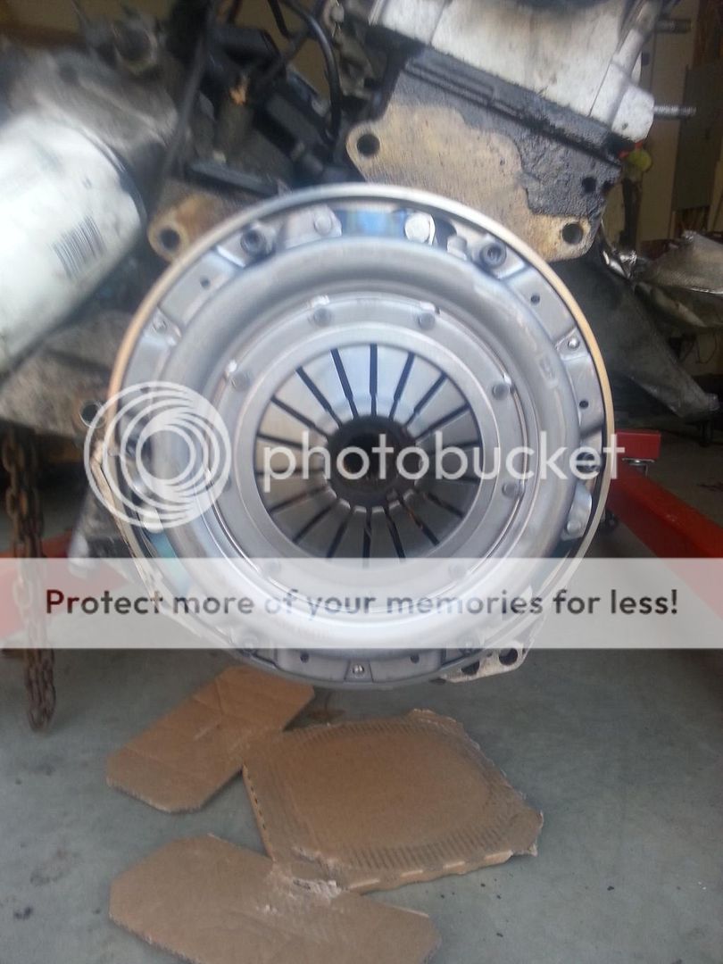

This is what I had. I wanted to use it because I already had one that I knew to be good. It's about 1 1/2 inches too tall. That Chevy one looks like it might actually fit.
PostPosted: Sat Jan 24, 2015 2:32 pm    Post subject: Reply with quote
mcleod, tilton or some ram versions look alot smaller in depth, need to check release depth of your pp though vs the throw of the bearing so the clutch doesn't drag or hang up after clutch wear, has to have enough travel both ways so to speak...
