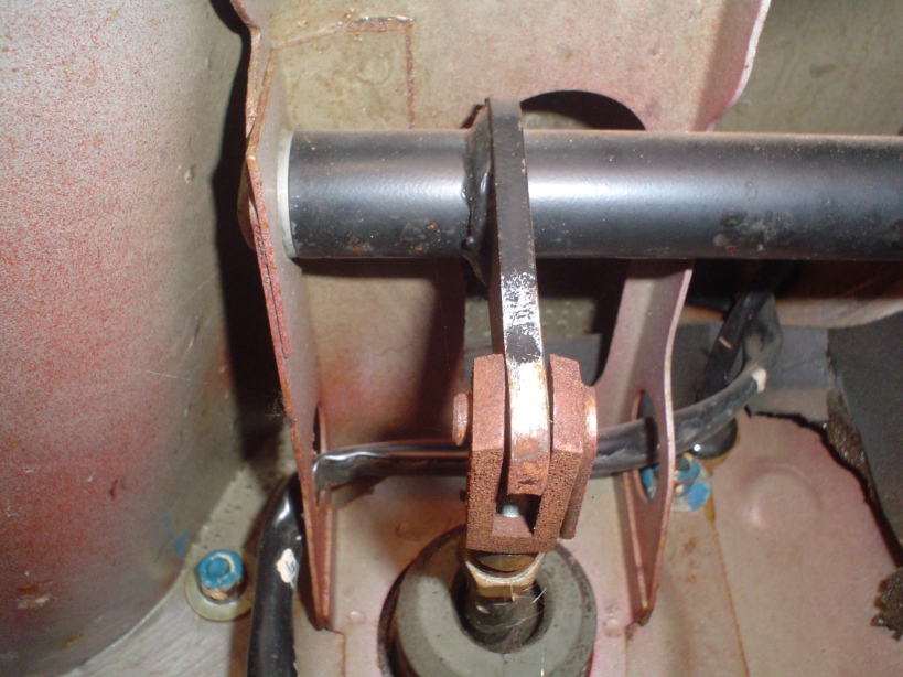

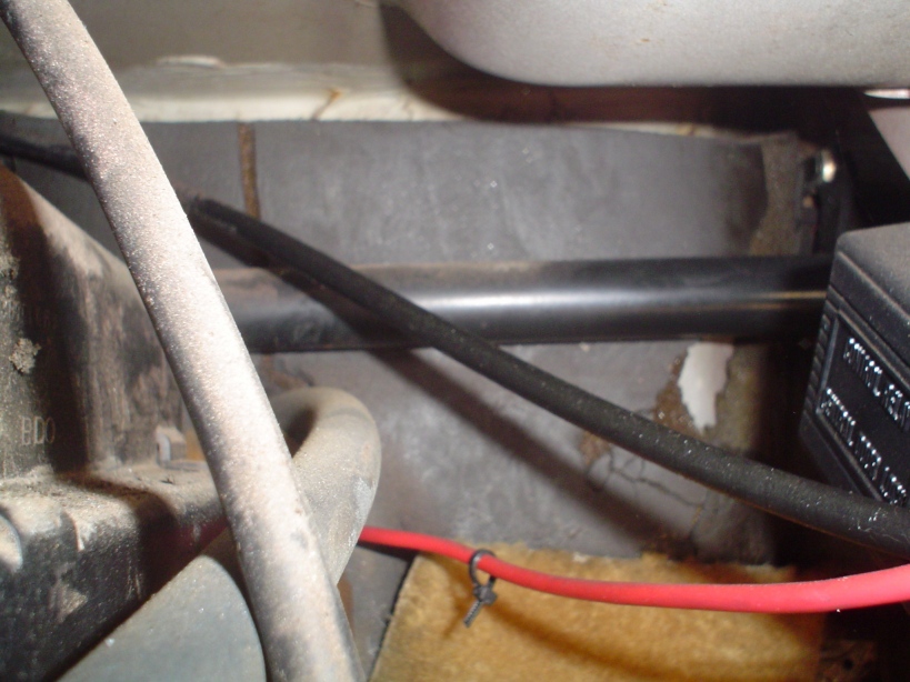

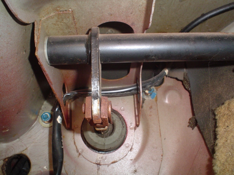

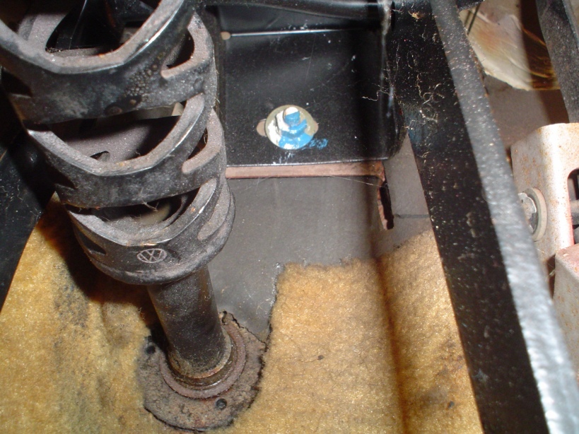

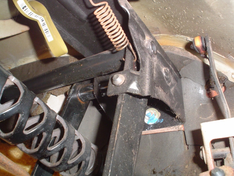

PostPosted: Fri Oct 24, 2008 2:39 pm    Post subject: Reply with quote
Here's some pics of what's under the skin of a RHD car. PM or email me if you want me to email the full size pictures.
The structure holding the steering column is probably the same as the LHD cars so you might be able to just drill out the spot welds on the existing metal work and reweld it on the correct hand side
Here's what the pedals look like:
Here's the bar from the brake pedal to the booster I was talking about:
If you have a look at the PET the RHD brake pedal is mounted in a metal box structure which is not on the LHD cars.
Hope this helps.

PostPosted: Sun Oct 26, 2008 3:09 am    Post subject: CONVERTING A LHD TO RHD Reply with quote
Thank you guys,
The photos are most helpful and it seems definitely do-able.
