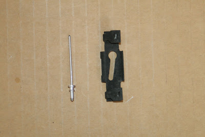

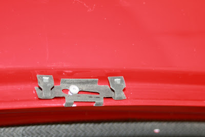

Here is a photo of the steel rivet and the clamp:

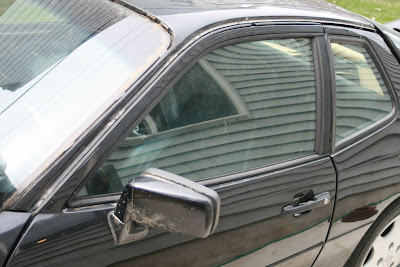

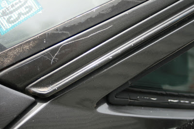

Here are two closeups of the old-school concave rain channel:

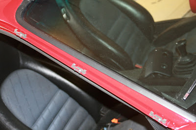

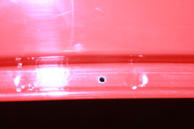

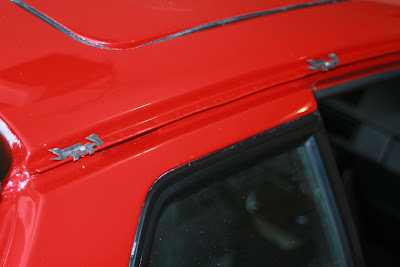

Remove parts from donor car. The later style channels are very difficult to remove without damaging the paint on the body, and without bending the rain channels. BE CAREFUL! Patience is required. If you're pulling from a salvage car, you don't have to worry so much about the paint on the car, but the channels are flimsy and will bend VERY easily, making re-installation much more difficult. It helps to have a thin-bladed to screw driver to gently pry the channel away from the clip. Once you get the first one to "pop" loose, you can gently tug on the rain channel as you progressively pry on each successive clip. On my donor car, there were six clips per side. Interestingly, PET says only 12 clips and studs are required, but there were actually eight studs on each side of the car. Here's a couple of photos to give you an idea of where the studs are located on the pinch weld:

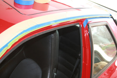

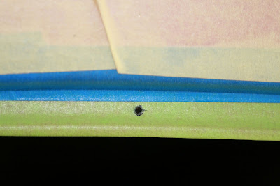

Next, make a note of the location of the rivet studs on your donor car. (I will post back later with approximate locations). On the donor car, apply masking tape to the pinch weld to help prevent the paint from lifting during the drilling process. Use the sharpie to mark the location of the studs on the recipient car. Use a center punch to prep each of the drilling locations.
STEP 3: DRILL
Using a 3/16" drill bit, drill each of the holes (6 per rain channel). I found some nice long bits with a reinforced shank at Sears. The extra length comes in handy to help prevent the spinning chuck on the drill from coming into contact with the roof of the car. I used a milk crate to stand on so I could better control the drill, particularly at the moment it breaks free through the pinch weld. When you're done drilling, remove the masking tape.

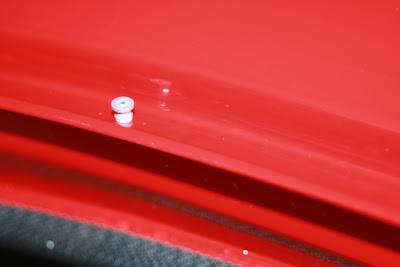

STEP 4: INSTALL RIVET-STUDS
One at a time, press the rivet-stud into the hole, and carefully use a hand riveter to secure them. I had to use a lot of care during this step because the width of my riveter nearly interfered with the curve of the roof line and would have easily marred the paint. I used towel to help keep the riveter from contacting the fresh paint.
STEP 5: INSTALL CLAMPS
The clamps sort of slide and lock into position. On a couple of the rivets, I had to very gently and slightly bend the lip of the rivet on the outward facing side in order to get the clip to slip under the lip. The rivets are pretty soft, so be careful! I then used a flat-bladed screw driver to gently tap the clamps forward to lock them securely in place.

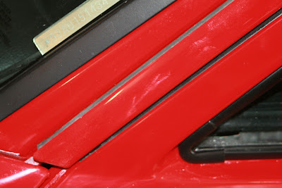

STEP 6: INSTALL THE RAIN CHANNELS
The rain channels have quite a tight fit over the clamps. I found it necessary to use a large towel and a rubber mallet to firmly tap the channel into place. Once in place, the rain channels won't budge!

Enjoy the sleek updated look of your new rain channels

The only thing about using normal rivets is that the clips don't exactly sit flush on the pinch weld, the stud that they slide onto on the OEM rivets holds them secure, but there's still a bit of a gap. You might be able to get regular rivets to work, but I didn't attempt it once I found out that the OEM ones were available on not too terribly expensive.
