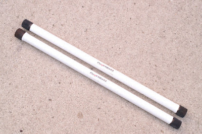

Posted: Fri Jul 17, 2009 11:31 am Post subject: |
I've had these 30mm torsion bars for a while...guess I better photograph them before they're installed in the torsion carrier!

Joined: 01 Oct 2004 Posts: 15548 Location: Spring Lake MI
Posted: Fri Jul 17, 2009 9:30 pm Post subject: |
Thanks for the kind words guys!
Raceboy wrote: | Are you sure you didn't want to go the "delete torsion bars and install coil-overs" route? |
Dutch924-racer wrote: | Why not go for coil-over rear shocks ? |
Now that is a loaded question!
I don't want to spawn off another huge debate, so I'll just summarize in two points:- Because I already have the torsion bars (i.e. I don't have to spend more money to get the coil overs)
- Because my chassis is a 1980 and I'm not convinced the upper shock mounts are up to the task of supporting the whole weight of the car.
I have considered long and hard going that route. However, in all of my research, I have not been able to come up with satisfactory documented evidence that it is safe to run t-bar-less coil overs on the early chassis. If I were to go just coil overs, the only way I would do it is by addressing the weakness in the upper shock mount and frame rail. Which adds more cost and more delays into the project. Quite simply, I have the t-bars, I know they'll work. If I ever desire to upgrade the spring rates all the way around, my rear shocks will allow me to add coil overs rather than swapping in larger t-bars. So it's sort of the best of both worlds. _________________ erstwhile owner of just about every 924 variant ever made |
