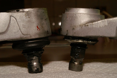

Now, I learned something very useful in the last 24 hours. The late offset alu A-arms are not all rebuildable
The pair I got were removed by a reputable source from the same 1987 944S, but the RHS arm is a non-rebuildable version. The rebuildable arm (LHS) is part number 951.341.149.10; the non-rebuildable arm (RHS) is part number 944.341.150.02. Oddly neither of these part numbers show up in the parts catalog or on Pelican's search engine.
I'm not sure if the 944 vs. 951 part number is an indicator, but the dead giveaway as far as I can tell is that the cup that the ball joint sits in has a different casting between the two versions. In the following closeup, you can see the rebuildable arm on the left, and the non-rebuildable one on the right. You can also see in the profile shot how the one on the right has a different casting. Note also the removable circlip on the LHS arm. I believe one of the other ways to tell them apart is by the type of moisture barrier used (which I've already removed on both arms), but I'm not positive that this is conclusive. The rebuildable one had a dark amber type material that I had to heat up to remove. The non-rebuildable one had a light grey rubbery material that was easy to scrape away with a razor knife.
I'm in the process of tracking down a replacement for the RHS arm. When I get time, I'll update the appropriate suspension-related threads with this new, crucial bit of info.

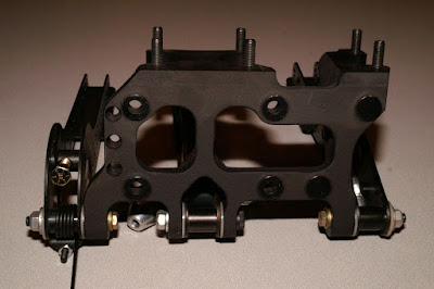

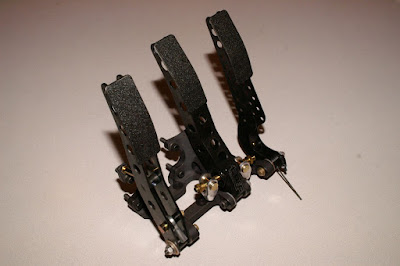

Tilton 600 series 3-pedal assembly

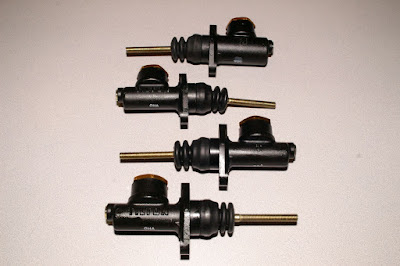

On top, we have a 15/16" master cylinder to be used for the clutch master; following we have 3/4", 7/10" and 5/8" cylinders, which will allow me to play around with the pairing and balance for the dual cylinder setup for the brakes.

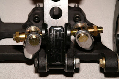

And if that's not enough to get things adjusted to our liking, we'll use the remote mount bias adjuster:

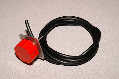

Add a remote mount three-chamber reservoir setup for standard -AN4 fittings:
And finally, the throttle cable adjustable linkage:

PostPosted: Wed Jun 03, 2009 8:15 pm    Post subject: Reply with quote
Raceboy wrote:
Very, very nice! If it's not a secret, how much did this Tilton pedal assembly set you back?
Just over $1300.
bass gt is running one of these, and I selected the brake master cylinder sizes based on his feedback. The Tilton rep said to use 3/4" and 13/16" cylinders for the brake config. Steve is using two 3/4" cylinders and recommended going a size or two smaller because he felt that his setup was a bit too "wooden", and thought the smaller cylinders would help. Ultimately, it is all a matter of personal taste and driving style. Since the cylinders retail for only ~$100, I decided to get the range that I did in order to have some flexibility in sizing. Remember, this is a completely boosterless setup!
Also, I decided to pay a little more and get the cylinders and reservoir with -AN fittings instead of the OEM-style crimp-on fittings. It will cost a bit more to get all the stainless hose and fittings, but in the end, I think it will be better.
I had also debated long and hard on whether or not to get the accelerator. You can get the two-pedal assembly for less than half the cost of the three-pedal setup. However, because of the way these mount to the floor, and also because of the way the 924 floor slants up immediately behind the mount point of the stock accelerator pedal, I didn't want my accelerator and brake-clutch pedals to be that mis-aligned. I finally decided to "bite the bullet", paid the extra to get the three pedal setup. By the time you add in the extra for that, the throttle linkage assembly, the extra master cylinder, and the extra expense for -AN fittings, it ended up costing between $500-$600 more than the bare-bones basic two-pedal configuration. So you could get a two-pedal brake-clutch only in the $700-$800 range.
A footnote to the whole thing, EBS usually doesn't stock Tilton products but they can get them. I did some comparison price shopping between three major Tilton resellers, and EBS matched the pricing, so I was happy to give them the business.
