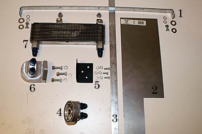

Photo of raw materials
1. MOUNTING BRACKET for REMOTE FILTER MOUNT
Using a 6"x18" inch sheet of 16 gauge sheet metal (item 2), I used a hack saw to cut out a piece that measured 3" wide by 5" long. I scribed a line at two inches, and clamped this piece between a 2x4 and my work bench, leaving three inches sticking out. I then used another piece of 2x4 to bend the piece at a 90 degree angle, using a hammer for some fine tuning. I then cut angles on the bracket (item 5) to match the shape of the remote filter mount (item 6). It's hard to see this detail above, but is clearer in the finished pic below. Finishing touches were to drill holes for the remote filter mount and also to mount the bracket to the frame rail (mounting location detailed below), followed by a coat of dark blue paint to match my engine compartment.
2. MOUNTING BRACKET for OIL COOLER
Using a 48"x1" piece of 1/8" steel (item 3), I cut out a piece that was just over 26" long. Using the same technique described above, I formed two 90 degree bends, each an inch long on the ends of this piece to form the mounting bracket (item 1) for the oil cooler (item 7). Finishing touches involved drilling two holes to mount the cooler, and two holes to mount the bracket in front of the AC condensor (mounting location detailed below). Also pictured above is the block adapter (item 4).

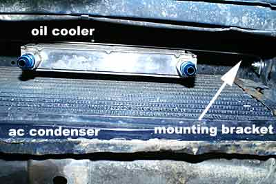

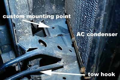

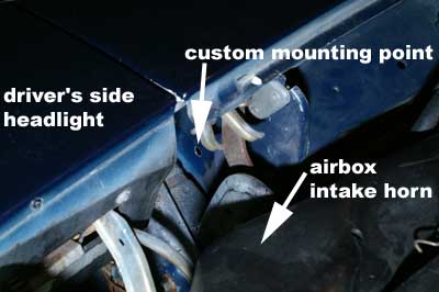

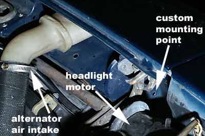

3. MOUNTING LOCATION for OIL COOLER
Underneath the nose header panel, and in front of the rad / ac condensor, there is enough room for the oil cooler. I found very nice points on a vertically oriented, front-to-back surface between the headlight and the rad where I drilled mounting holes, as pictured below
Pass. side oil cooler mounting location from beneath the nose:
Same mounting location viewed topside:
Driver side oil cooler mounting location viewed topside

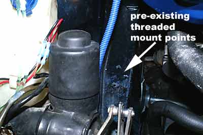

4. MOUNTING LOCATION for REMOTE FILTER MOUNT
On the passenger side frame rail, in front of the wheel well, there were already three very nicely positioned holes that were already tapped for 6mmx1.0 threads. I made a pattern of these holes when drilling the holes on the mounting surface of the bracket for the remote filter mount:

Here is a pic of the mounted cooler from beneath the nose. As you can see, the bracket can be swivelled on its mounting points to accomodate the desired clearance and angle to keep the cooler about an inch or so from the AC condenser:

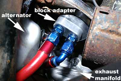

Here is a pic of the installed block adapter:

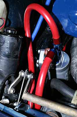

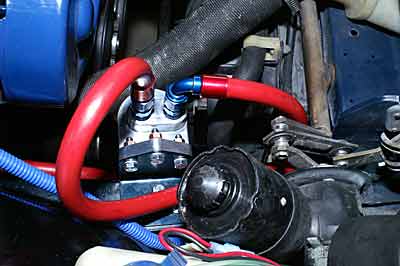

Here is a pic of the installed remote filter mount. In this photo, you can see how nice it looks having the bracket follow the shape of the top of the remote filter mount:
Here is another pic of the installed remote filter mount:

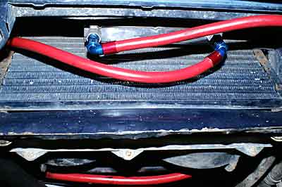

Here is another pic of the installed cooler with hoses attached:
Getting the three hoses oriented and situated was a bit of a trick...they were actually a little long, so I had to be somewhat creative in how I routed them to avoid pinch points, abrasion points, and kinks. I will be using a bunch of 8" zip ties to secure everything once I'm satisfied with how they're all routed. Getting them just right required removal of the belly pan.
SUPPLIES:
18"x6" sheet of 16 gauge sheet metal
48"x1" stick of 1/8" galvanized steel
Two 8mm x 1.0 thread x 40mm bolts for mounting cooler bracket, along with the requisite nuts and lock washers
Two 6mm x 1.0 thread x 30mm bolts for mounting the cooler to its bracket, along with the requisite lock nuts and washers
Three 8mm x 1.0 thread x 50mm bolts for mounting the remote filter mount to its bracket, along with the requisite lock nuts and washers
Three 6mm x 1.0 thread x 30mm bolts for mounting the remote filter mount bracket to the frame rail
Four 8mm washers to shim the gap between the oil cooler bracket and the mounting points on the car (the bracket ended up being 24" long, but the mounting points were just slight further apart ... I used two washers on each side to provide a flush mount).
Several 8" zip ties
TOOLS:
Hack saw with one fresh 18T blade
Drill with 8mm and 6mm bits
13mm wrench and socket
10mm wrench and socket
3/8" drive ratchet
3/8" ratchet swivel adapter
3/8" various ratchet extenders
Hammer
Two pieces of 2x4, about 1' long
Sturdy work bench
Two 4" C Clamps
