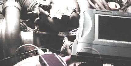

The kit as it stands now:
· Smaller unit, easier to fit into “any” engine bay
· Belt configuration currently matches the 944 AC & ALT
· You keep your AC it fits with the ALT and AC you loose your stock air box.
· I have a hard pipe for the intake and AFM, although I prefer a MAF or MAP setup, the average guy only has a AFM.
· I am using my own 5th Injector setup, engages at anything above 2 PSI.
· Running my own alcohol and water injection -- I am overly cautious. So this is my insurance.
· In the past I found the 5th injector is an ample solution
· Tested a FMU as well... interesting configuration, but can be made to work well. |

I am not posting complete pictures of the install, especially since the mounting hardware and all that are still in a rough state. Alpha stage:
My choice, may not make everyone happy… but hey that’s the way it goes…
If you wanted to do this yourself without a complete kit, you need a supercharger then just figure out the install brackets, timing and fuel delivery.
So you have a visual on the 944, remove the entire AIR BOX assembly above the alternator, use a bracket setup that supports the supercharger above the ALT, use a serpentine belt with tensioner.
So the supercharger pictures are posted.
Granted its raw and dirty... but it cleans up real nice!
Now if you really want to discuss large boost numbers we can talk Jake/Counter Shaft... which adds a third ratio.
See previous posts for an idea... and believe me this universal prototype moves more than enough CFM.
