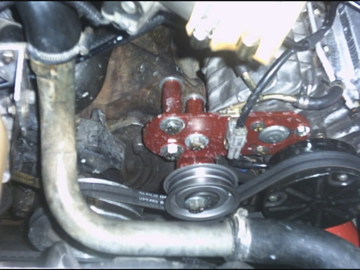

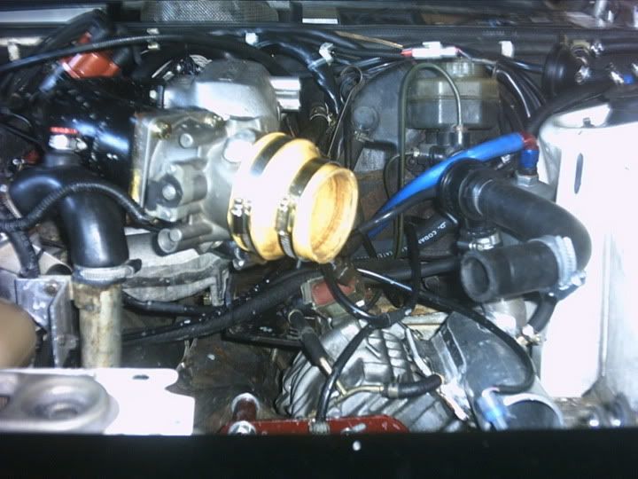

Here some pictures of my project to date.
The blower has been installed, it is a SC12 from a MR2/4AGZE engine and retains the magnetic clutch and vent lines for the gear housing, both are operated off the same relay.
The SC mounts are made from 5mm steel, the front mounts off the three bolt tang where the air con mounts(removed previously) this is at a horizontal line and the blower mounts at 45 degrees, a top mount supports the top off the blower and attaches to the manifold where the triangular manifold to block support used to be. I also made an engine damper that is attached off the bottom of the blower to the crossmember, this dramatical reduces engine and accelerator pedal vibration, my car never had the factory damper or provisions for mounting them.

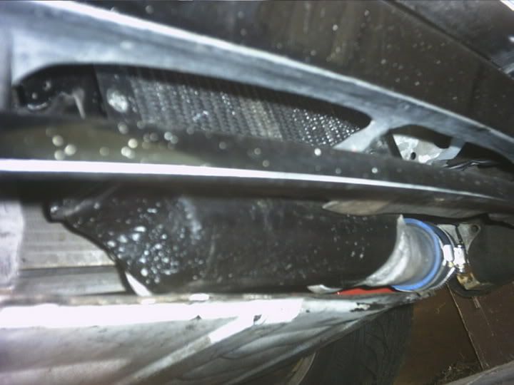

Custom inlet and outlets have been made from aluminium, with all other piping to/from the intercooler being 2.5".
The SC is set to come on at 1400RPM and .4% throttle, the throttle positioning is due to balancing the airflow through the air bypass solenoid and to make idle easy to tune. It also is set to come on after the engine has warmed up , around 65 degrees.
It is currently running 3psi at the manifold through a WRX 97/98 intercooler. The intercooler is a top mount modified so that airflow is reversed and the dual outlet is now running a single 63mm intake from the side.
A 3" diameter plenum mount was made by me to mount the ford XF throttle off, this also caters for the air bypass solenoid form a ford XF. In hindsight a smaller throttle would have been better suited and due to the tight curves 2.5" tubing could have been used.

I need to have another aluminium crank pulley made up as my inital calculations could not fully take into account the efficiency of either my engine or the blower, I actually overated these figures and the 130mm pulley will see a 20mm diameter increase in size and yield around another 3 to 4 psi. This new crank pulley will also be set up will a trigger wheel to run distributorless ignition.
The old pulley will be made available to someone who wants to run a similar system without an intercooler and will make aound the 3 to 5 psi mark with and SC12 slightly higher if you get the later model blower that had the 5mm smaller pulley, there is also an aftermaket blower pulley that would be another 5mm smaller again but a new stator is required. If used with the SC14 higher psi would also be achieved.

the XF throttle is 68mm, I sugesst something around 55 - 60mm would be better suited. It's for low throttle smoothness, stops the car from wanting to launch off the line. Might make it a little easier on the cars clutch too.
The XF are plentiful and cheap. These body's are quite long though and another option would be a ford explorer unit which is also 68mm or going with a 944 throttle which is around the same size length but a smaller throttle plate from what I remember, I'll have to dig up one of my previous posts as i did have someone measure the 944 throttle for me. The XF unit I got was around a quarter of the cost of a second hand 944 throttle, but again it's off a 4 litre engine.

Pulley sizes are 115mm supercharger crank 130mm
I will be getting someone else to make up a new crank pulley out of aluminium. Groves are a standard size to run a 5 rib pulley. No fancy stuff required here, just match it to your whipple pulley. As for angles I'm not sure exactly, might need to do some research there.

Plenum size needs to be ...at least the engine displacement... So around 3 ltrs would be a better option. This site http://www.sdsefi.com/techinta.htm recomends 3" tubing for 1600cc engines and 4" tubing for engines above.
If your making it out of aluminium then its going to be 80mm or 100mm tubing as the next sixe down is 63mm.
The length needs to be slightly longer than the head for better end cyclinder filling and therfore;
80mm tubing X 40cm length = 2.01 litres
100mm tubing X 40cm length = 3.14 litres
I think the 100mm tubing would be the better chioce with shorter runners for high RPM torque or longer suited to low end rpm torque.
As for throttle placement well there are many factors... shortest route from intercooler, even cylinder filling and space requirments are all factors. If you were to be running no intercooler then a twin throttle coming dierctly from the SC outlet into the side of the maifold would be a good idea.
Seeing as you are running an intercooler the a front mounted throttle would be logical with slightly shorter runners for low to mid rpm range with velocity stacks incorporated into the design. This should accomodate for the number 4 cylinder getting enough air to it and also improve the airflow reported to be up to 25% better.
As you would see mine is running in the stock location, this was mainly due to time constraints. I drive the car daily as well and so until the manifold is in place no oulet tubing could be constructed for the intercooler.
With what I've learnt from the project so far I will be able to get the rest constructed and essentially plug and play install the new parts (manifold / throttle).
Also in regard to the throttle, for a blow through arrangment such as mine you want all the ports to be blocked. I am running with one open for an air bypass solenoid (also of an XF falcon) that runs around the throttle.
This is only for warm up operation and runs essentially closed after reaching a set temperature. The are a little hard to tune when warming up as the boost can give the solenoid a hard time trying to close but if you reverse the input for the output it works better (go figure that one out).
This has more to do with the response time when cold though, as it has to open really quickly when off boost (sc is clutch operated at 1400 rpm) in order for the car not to stall. The difference in travel time reduces once the car warms up. My car requires alot of flow when cold and very little when warm.
