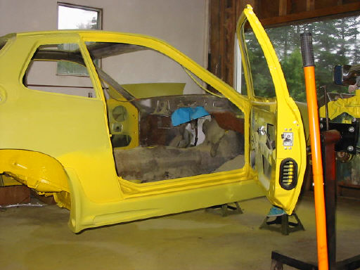

I have been plugging away at this project with all my spare time & MONEY! Results are slow, but rewarding.
17" rims are repainted and have the new Hankook tires installed. 255/45/17 on the rear.... looks nice and wide
The machine shop is dragging on with the manufacturing of the wheel adapters. We did a swap. I painted his 52 morris minor convertable in exchange for building the adapters.
All the suspension parts have been sand blasted, epoxy primed and painted base coat/clear coat. Double yellow...2002 VW/Porsche color.
The under body was painted over the past week as well using a mixture of 3M rockguard and urathane paint. Looks real claen under there now.
I painted the door jams with the doors off the car and have installed the doors and fenders permanently.
The outside of the car is all primed with the tintable primer and ready for final blocking.
The 327 power plant was refreshed last weekend. We stripped the block, degreased it, pressure washed the block, polished the crank, honned the cylinders, installed all new bearings and rings and new oil pump. The heads were ported, new double roller timing chain, blazer cam (COMP CAM) roller tip rockers.
Everthing under the hood is ready for paint once I sand the primer for the top coat. It will take a complete day to do. So many edges and hard to sand areas.
I would love to see it painted and sitting back down on it's sneakers in a months time...we will see.
I build the car we ALL dream about.

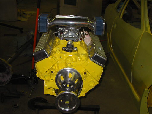

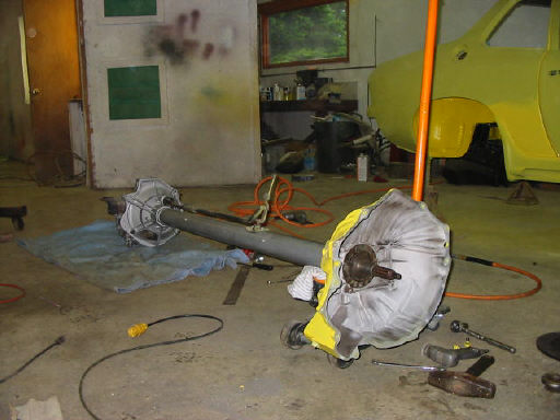

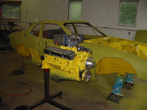

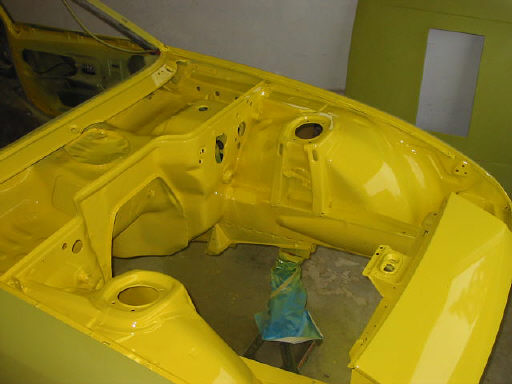

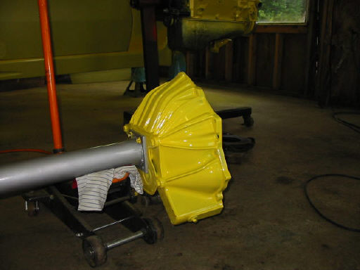

Here are some pictures of my work to-date.
As you can see there are some major mods around the brake booster area. That is covered when the booster is installed. Also note the notch on the left strut tower. That was done to make room for the brake lines. I had to move it that far over to clear the valve cover!!
You can all see the drive line connected together now. Simple to do.
The transmission, drive tube, bell housing and rear suspension is all back under now. When I get the new chrome base pan for the engine I can install that also. Oh yaeh I need to grind and polish all the stainless steel engine bolts first and bolt the intake, timing chain cover etc.
